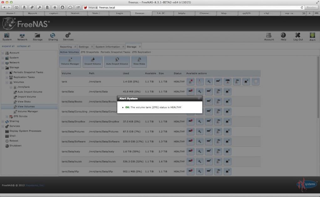

I just came across an odd issue. I'm running FreeNAS-8.3.1-BETA2-x64 (r13015) on a Dell R610 connected to an MD1000 JBOD. I've been running this config for a couple of years now. Its been quite solid. Yesterday, I physically moved my gear to a different room. When I brought things online, I got the following message:
55725 (Fri Jan 18 00:21:00 PST 2013/ENCL/CRIT) - Enclosure PD 00(e1/s255) phy bad for slot 9
55723 (Fri Jan 18 00:21:00 PST 2013/ENCL/CRIT) - Enclosure PD 00(e1/s255) phy bad for slot 4
55724 (Fri Jan 18 00:21:00 PST 2013/ENCL/CRIT) - Enclosure PD 00(e1/s255) phy bad for slot 6
When I login to the webby, I see no such claims about any errors at all (The alerts icon is still green, and the storage section claims things are healthy. See screenshot attached). I checked the cli and got the same results as the webby. I'm left wondering why this was sent out.
Basic google didn't turn up anything that seemed particularly relevant. Any thoughts about what this means?

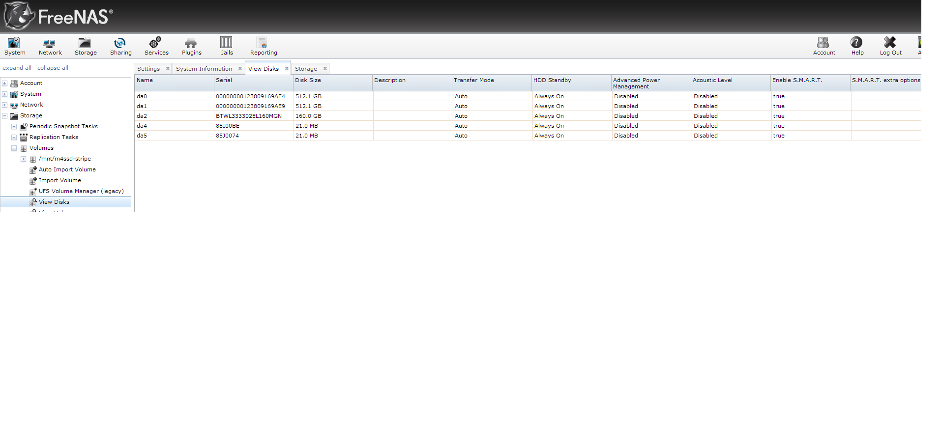

The box has a SAS 6I/R for the 6 2.5" slots. I had a 5e for connecting the MD1000, but I have switched to a sas5e. With the PERC, I had to create a collection of RAID0 volumes, one for each drive. It made things annoying, so it got swapped out.

ok, thanks. i have a crossflashed m105 internally and a sas5e (not perc) for the md1000 but i only see 2 'disks' which look like the EM / enclosure managers (?). it's definitely not a perc5e. I've got a 8088 lsi card on a truck, will try with that and see if I can get the freenas server to see any individual disks, right now it only sees the internal ones on the m105 and 2 non-disks listed as disks. i've rebooted the box to no avail. maybe i'll reboot the md1000 as well next time i'm on site.

rebooted the md1000, no change. i confirmed it was a SAS5/e (not a perc) connecting to the md1000 externally. just in case it was the dell sas5/e card, i pulled it and replaced it with an LSI 9200-8e and different cables, and it looks the same. DA4 and DA5 in the attached screengrab. Off to google how to factory reset an MD1000.

pardon me, but 21MB is a freakin' weird size! Is that actually somehow accurate?
Just out of curiosity did you make sure your firmware on your LSI controller matches your driver?
