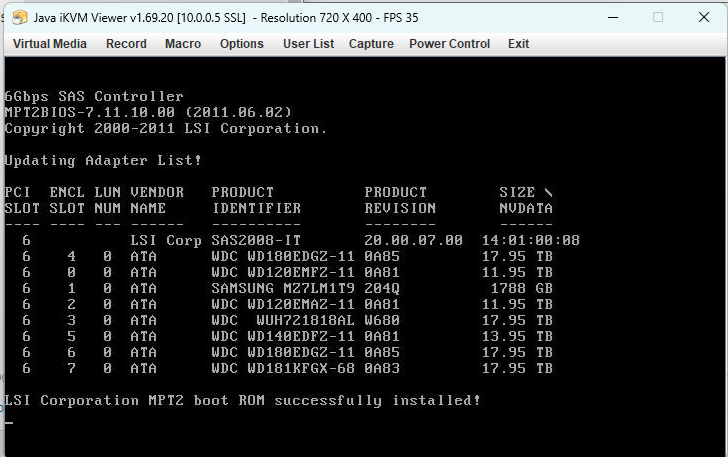

Edit 2: Here is the boot info I captured from the IPMI iKVM about the Dell. Based on my reading , I'm not sure if this is a good firmware revision?
