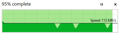

The raidz pool (x4 3TB) is fine as well, until you write a larger file, eg. to a Samba share. After around 4-5GB the transfer pauses for 10 to 30 seconds, then starts again, and depending on the size of the file it can pause again, and start again until it finishes. The transfer speed is maxing my 1GB network at 90-110mb/sec
The dips here are where the transfer speed goes to 0.

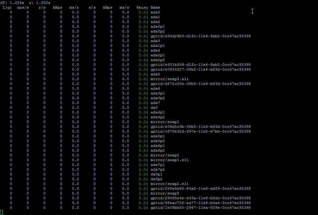

looks like you have problems with some harddrive
try to run a command when make a large transfer, iostat and gstat to see RAW transfer from HDD subsistem
and if you see something in red (on gstat), I think you have some "bad" at HDD level
succes

Hey Dan, thanks for the reply. I did think about a hardware issue, but i couldn't see anything that looked obviously wrong. Under gstat i can see the drives are loaded heavily (busy going red?), but if writes are being pushed near maximum that would be expected i suppose?
The drives in the raidz are ada4/5/6/7. ada 2/3 are the mirror and ada1 is the mirror SLOG.
I attached a gif screen capture of gstat while a ~4.5 gb file is being written. Hopefully just open it in a new tab and it will play.
