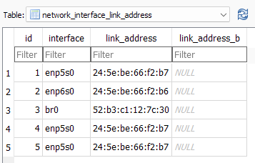

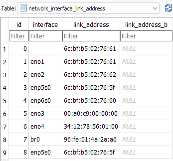

edit: when it's broken it has 1 interface twice ignore the eno1234 they're spf+ or w/e they're just holes at the back of the mobo I don't even have the fibre connectors

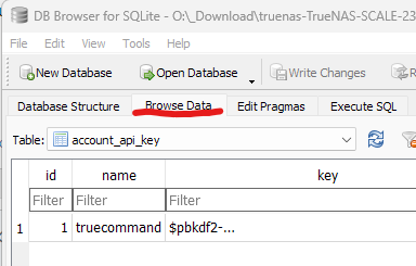

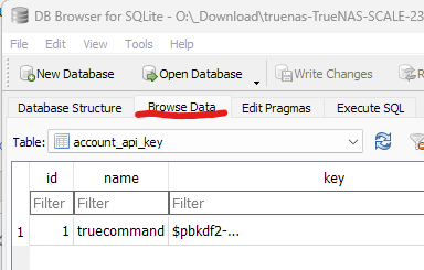

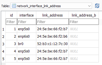

Now onto the part where we manually butcher a database - always a fun time! Download https://sqlitebrowser.org. Open the broken "freenas-v1.db" in it and go to Browse data tab.

At the end of this step the only table starting with "network_" that should have anything in it should be "network_interface_link_address" and it should only have single record for each of your interface, ie the broken database I'm screenshotting for purposes of this post has (offtopic rant, but curse forever whomever came with the nonsense names beased on their pci lane or w/e rubbish. My cards are eth0 and eth1 and noone will tell me different *shouts and shakes arm at cloud*):
clearly the bottom 2 rows are absolute utter rubbish and you would need to delete those (and the bridge too according to instructions above innit).
