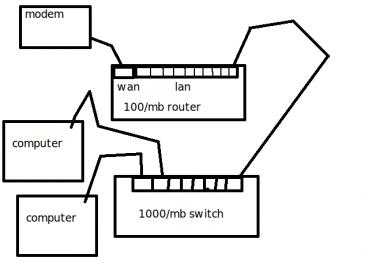

here is a diagram. it's crude, but it's 2 am and I'm not an artist.
all your computers will talk at gigabit speeds (provided they have gigabit nics) and will communicate to your router at 100mb/s.

Ok I see, but I didn't know computer could talk to each other just by a switch without having to pass through a router.
Thank you.
May 27, 2011
566
routers are only needed to communicate across subnets. everything internal to your network is on it's own subnet (192.168.1.0/24 most likely).
