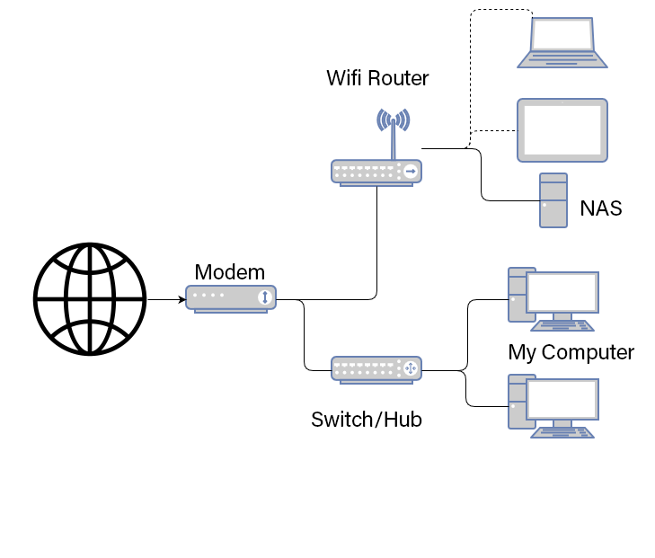

OK so ... Network setup ...
ISP -> Modem -> 2x IPs
1st IP -> Wifi router for home use
2nd IP -> Switch -> office hardline computers & NAS Server

You have to plug the NAS into a port of your Wifi router. Or buy an additional switch if the router has got only one port plus Wifi.
lilg
Jun 23, 2020
21
OK - so if I hardline the NAS on the Wifi router, can I access it from the Office computer considering it is on the other ip, using this setup above?

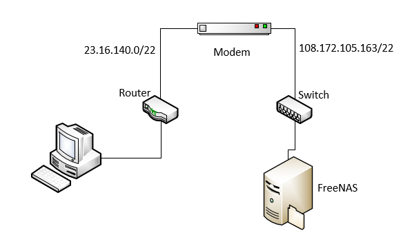

Let me sketch this up in Visio, so we all understand what's going on. Gimme a few.
Samuel Tai
Apr 24, 2020
5,399
OK, is this how your network is laid out?

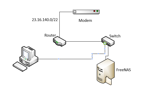

If it is, then you should swing your hardline switch behind your router, and then re-IP everything to the 23.16.140.0/22 network, and the various guides will then work.

@Samuel Tai If the router is not just an access point and so essentially a bridge, shouldn't the 23. network be behind the router? Or yet another perfix on that second interface? I am wondering where the DHCP server is located in this setup? At the ISP, hence the RFC 1918 address? I admit I have never seen anything like this.
Patrick M. Hausen
Nov 25, 2013
7,776
So essentially you plugged your computer and the NAS into "the Internet" without any router and firewall inbetween. This is not how this is intended to work in most cases.
Patrick M. Hausen
Nov 25, 2013
7,776
With most ISPs the idea is to plug a router into the modem and literally everything behind that. Who advised you to create a setup like this?

lilg
Jun 23, 2020
21
:) Advised. :oops: - I did it mostly to take full advantage of the unthrottled ISP Speed. The router I have is slower and I found an extra IP on my modem
