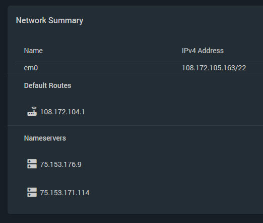

OK. Please provide the FreeNAS IP from Network->Network Summary, and your IP from a Command Prompt->ipconfig.
Samuel Tai
Apr 24, 2020
5,399
What about your PC's IP?
Samuel Tai
Apr 24, 2020
5,399
OK, FreeNAS and your PC are NOT on the same LAN. Please provide screen shots of Network->Network Summary, and your ipconfig output.
lilg
Jun 23, 2020
21
Patrick M. Hausen
Nov 25, 2013
7,776
Unless his netmask is 128.0.0.0
@lilg just ignore, please, I am joking with @Samuel Tai.
Please give us the complete network setup of both systems as requested by him. Thanks.
