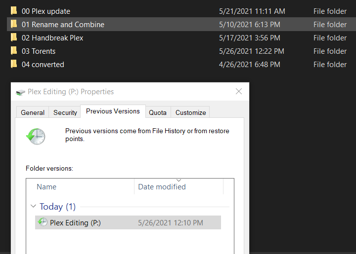

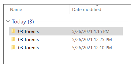

I updated to TrueNAS-12.0-U3.1 about 3 weeks ago because I heard that the SMB Shadow Copies were fixed in this version but it only works on the level that I have the periodic snapshots set. This is the top level of this share and this will let me go through all the folders.

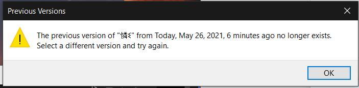

but if I go into a folder and try to check the pervious versions they show up but I get this.

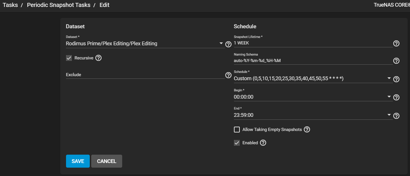

This is the settings in Truenas
Am I missing something is this a known issue.
