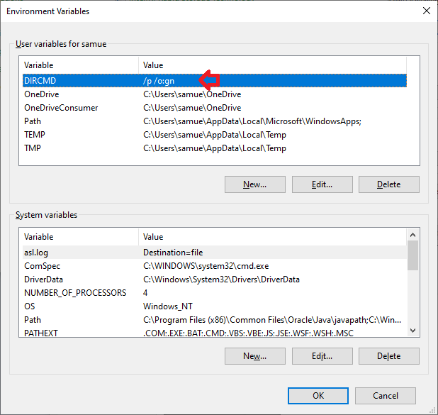

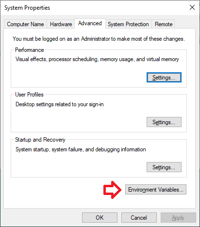

Have you tried setting a Windows system-wide environment variable?

I have not, very interesting. Will this system variable have an effect on windows dir listing functions made from inside a (c++) program? Let me test this ...
If it can be set on a GPO we might have a winner ... thank you.

@Samuel Tai This test (DIRCMD variable) actually worked, but it is not feasible to deploy in an enterprise with 600 workstations and people constantly moving around.

Just add the DIRCMD env variable to the domain login scripts. That's what we do where I work.
