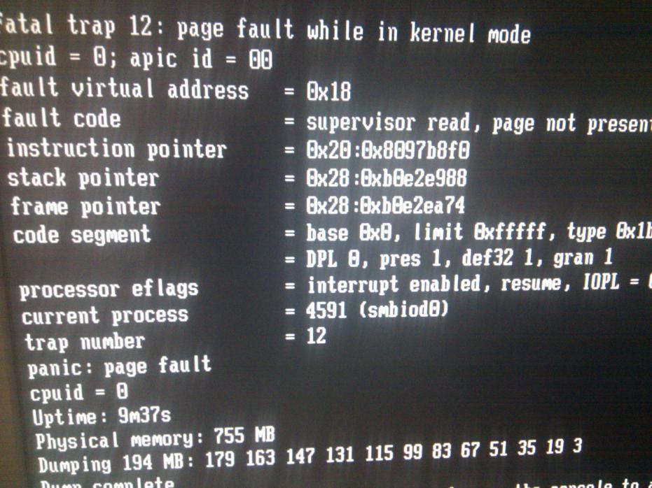

And I've now been trying to configure it for my windows boxes. However, there is a slight issue when it comes to as FreeNAS throws up a horrible error message (Photo attached)

and the command prompt locks up, when I wire a screen up to my FreeNAS box, I'm greeted to this:

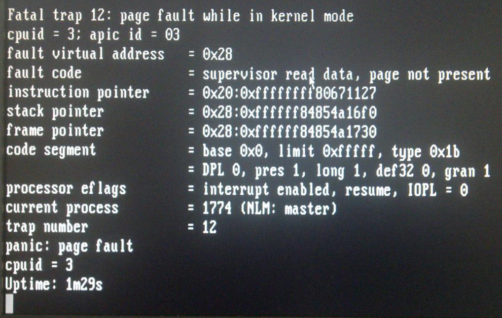

Unfortunately, add me on that list also.
There is a mix of computers in my network, including macs, linux and windows boxes. Windows 7 ultimate is the only box that brings FreeNas down with an error similar to the one above.
This error is trigger by an attempt to connect to the nfs share, either thru command line or windows "map network drive" option.

I have the same issue if i run the command:
mount_smbfs -N -I 192.168.2.250 //admin@server/DocBox /media/docbox
I used 8.2.0-Release-p1 and must go back to 8.04.
