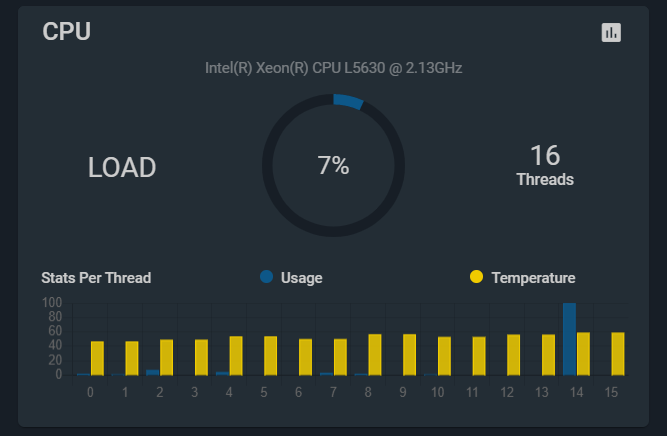

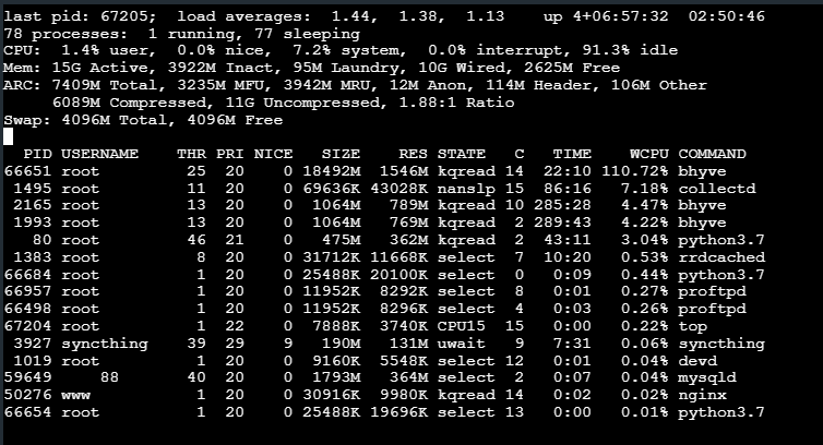

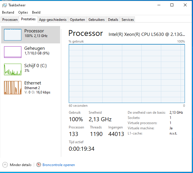

Even on a fresh install the cpu usage IN WINDOWS is 100% but the freenas dashboard show only 14% in use!

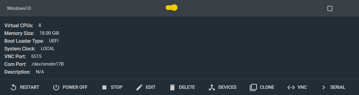

VM SETTINGS:
cpu threads: 8
ram: 18gb
12gb HDD space
Networking on vertIO

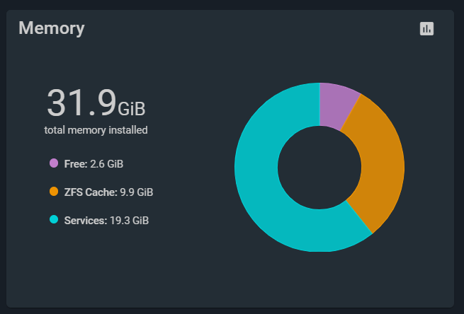

Some screenhots:
1587602958734.png 1587602989512.png 1587603028579.png 1587603054212.png 1587603117797.png

cpu threads: 8
I think this may be problematic... more than 4 is supposed to be an issue due to the way bhyve does sockets vs threads.
ram: 18gb
Fine.
12gb HDD space
That seems too small (even for installation).
Have you used the redhat/fedora VirtIO driver? The builtin Windows driver is known to have issues.
Also look at if you have the VNC device... remove it (after ensuring RDP is enabled) and use RDP.

Uhm i typed it wrong!
I surpose to mean 120GB HDD
I have vertIO network drivers from redhead if i remember it right!
I will try to set the cpu to 4 instead of 8.
And after that the HDD to vertio as well.
