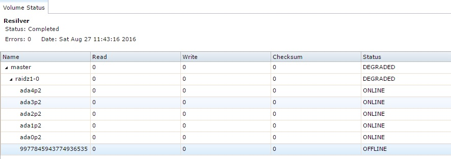

I tried to remove the encryption of disks by following the instructions at the web site http://freebsd93.blogspot.hk/2015/06/how-to-remove-encryption-from-zfs.html
unfortunately, after followed the first 6 steps on my first disk, the pool state still marked as DEGRADED.
I dare not to continue for the rest of the disks.
I totally have 5 disks. From the zpool status, they should be all online now. I guess it is because of the previous device"1a84a60c-9753-11e4-8571-d050991a79de.eli" which keep the pool marked as DEGRADED, shall I remove this device and how can I remove this device?
  pool: master
state: DEGRADED
  scan: resilvered 573G in 25h42m with 0 errors on Sat Aug 27 11:43:16 2016
config:
        NAME                                                STATE     READ WRITE CKSUM
        master                                              DEGRADED     0     0     0
          raidz1-0                                          DEGRADED     0     0     0
            replacing-0                                     DEGRADED     0     0   245
              9977845943774936535                           OFFLINE      0     0     0  was /dev/gptid/1a84a60c-9753-11e4-8571-d050991a79de.eli
              gptid/1a84a60c-9753-11e4-8571-d050991a79de    ONLINE       0     0     0
            gptid/1b7e29d1-9753-11e4-8571-d050991a79de.eli  ONLINE       0     0     0
            gptid/1c724fc0-9753-11e4-8571-d050991a79de.eli  ONLINE       0     0     0
            gptid/1cecd787-9753-11e4-8571-d050991a79de.eli  ONLINE       0     0     0
            gptid/1d61ebdf-9753-11e4-8571-d050991a79de.eli  ONLINE       0     0     0
errors: No known data errors

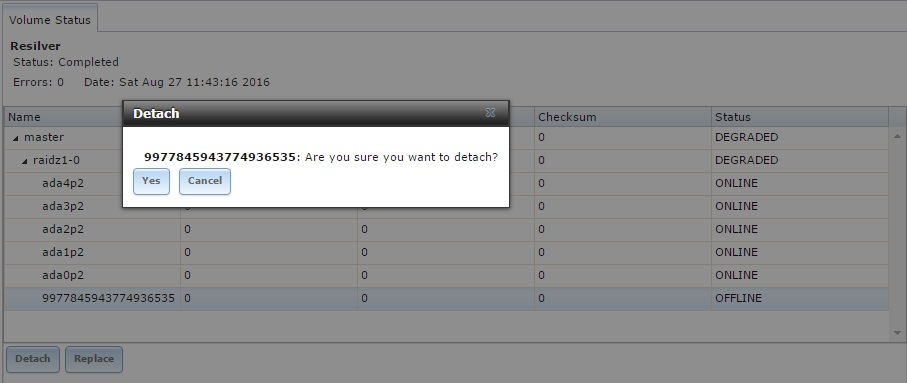

Solved!
I read the article on how to replace a disk in ZFS pool, it mentioned that the no longer exists old device need to be detached manually. I tried and it works!. My pool is back online now.

It was DEGRADED
Detach the non-exist drive

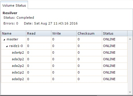

The pool is back online now.
