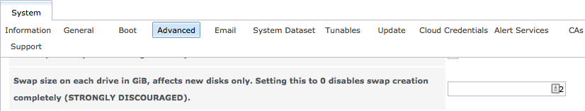

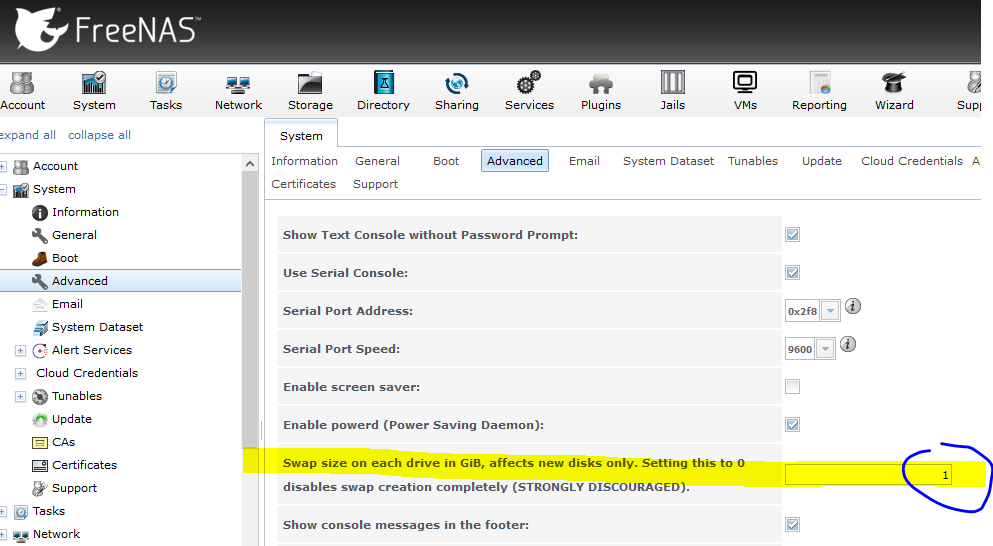

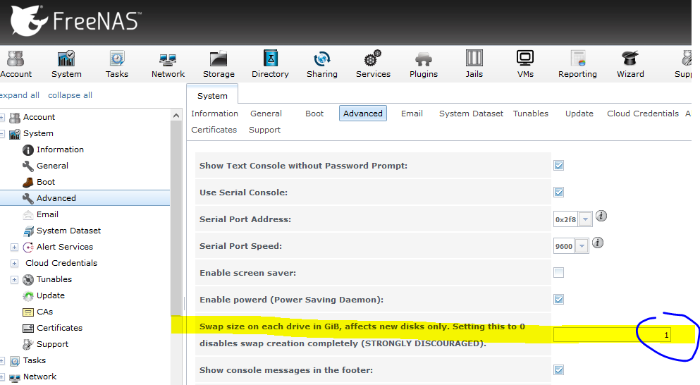

Chris Moore
May 2, 2015
10,080
I tried to do this, and I couldn't find the setting. When I was creating the pool, I went to STORAGE > VOLUME MANAGER and created the pool with the dialog box. I didn't see any settings (even under the Manual tab). Did I do something wrong? I'm running v11.1-U4.
It is in the System / Advanced menu, here:
NASbox
May 8, 2012
650
Thanks... I'm assuming once the system is configured and there is sufficient swap space set up on other pools that setting this value to 0 only suppresses the creation of new new swap space.
I also assume the "not recommended" applies to disabling swap completely.
