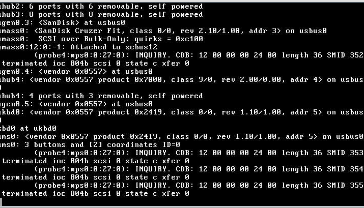

I had a boot drive "fail" so I replace it via the GUI. Now it has happened again. I tried 3 flash drives and I can't believe that all 3 are bad. 16GB Sandisk Cruiser Fit. Server has been running for almost 2 years with no issues. I need some serious help.

Ok I got in booting in "Verbose Mode". "Normal Mode" produces the OP errors.

I am not sure what you mean by Verbose/Normal nor what difference it makes.
When you boot FreeNAS, you get an option of which "boot" you want to boot to. IDK the actual name but you get a list,
Initial-Install
default
FreeNAS-9.3-STABLE-NUMBERS
Then once you pick that, you get 3 mode options:
Normal Mode
Single-User Mode
Verbose Mode
Normal Mode produces all those errors, Verbose let me boot all the way up.
