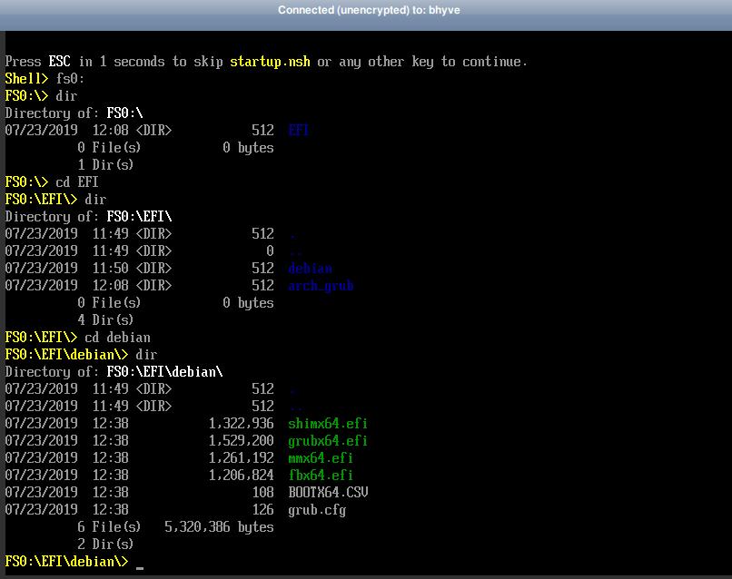

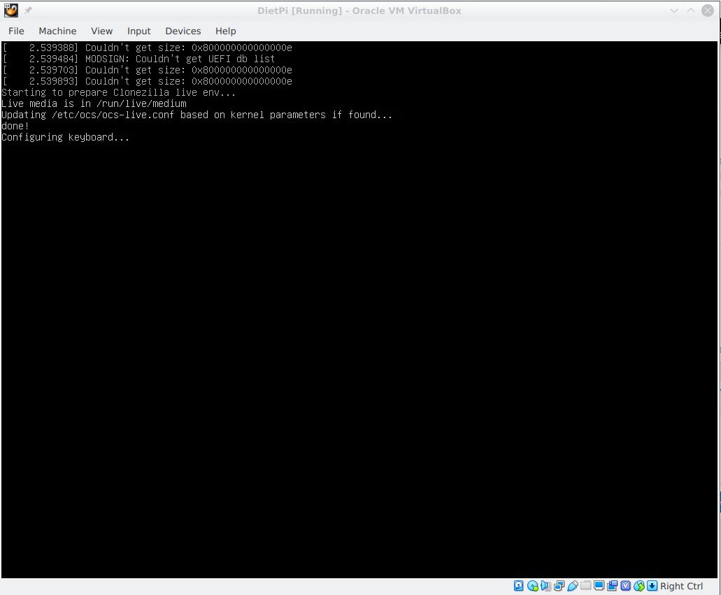

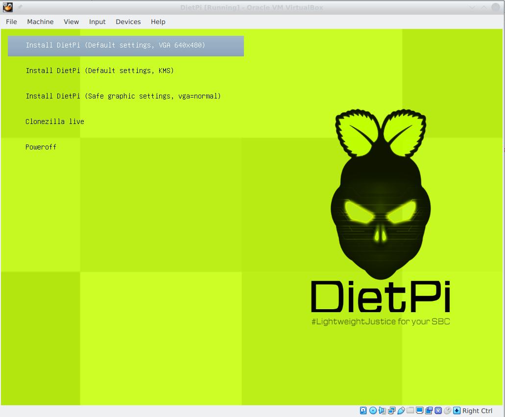

The DietPi_NativePC-UEFI-x86_64-Buster.iso does boot directly in VirtualBox, if UEFI is enabled. The grub menu options then invoke clonezilla live (syslinux baed) to "restore" an image which is embedded in the iso itself. Bhyve doesn't even find the "boot6x.efi" file ... hence drops to EFI shell.

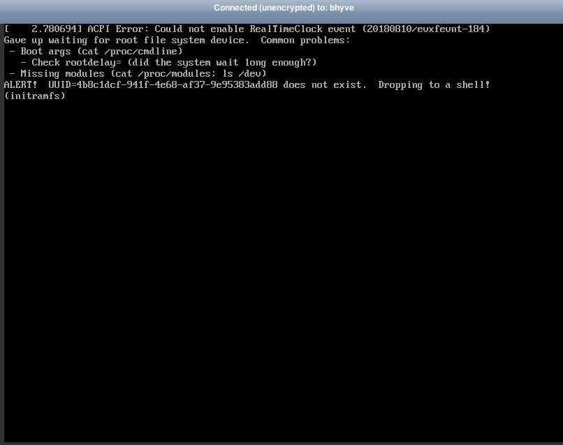

Ok, made some progress. Installed dietpi via UEFI iso in Vbox. Converted VDI to RAW file. Copied RAW file to FN and used dd to copy RAW file to a zvol. Bhyve still drops to EFI shell but you can navigate to efi files. It falls to boot. Looks like I failed to correctly turn VDI into a useable zvol. I'll leave it for today.

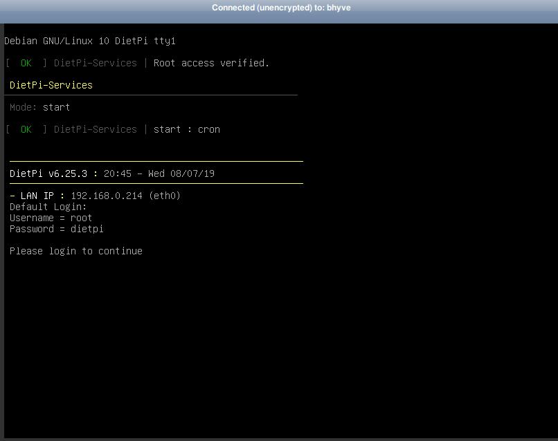

Bingo! Not sure why dd from VDI to zvol went wrong 1st time, but this dietpi on bhyve. ( EFI boot and fdisk size mismtch to fix)
9,700
I was able to follow your lead and get the same outcome.
I was also able to get it to boot automatically by copying /boot/efi/EFI/debian/grubx64.efi to /boot/efi/EFI/BOOT/bootx64.efi (needed to mkdir /boot/efi/EFI/BOOT first)
