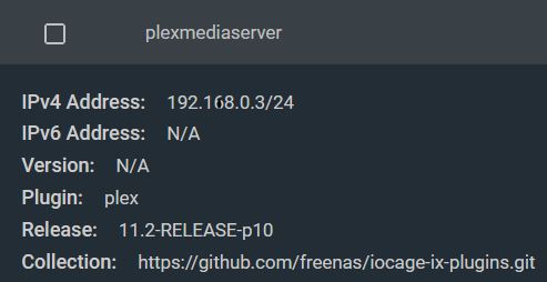

If you look at the plugin in the GUI, what's the name? Does it say "plexmediaserver"?

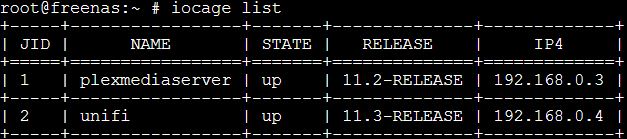

And what does "iocage list" show?
This?

Your plugin name is still "plex". Use the iocage command on page 1 to change that.

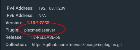

ddaenen1
Nov 25, 2019
318

Glad you got this sorted! And no, I meant 'iocage set plugin_name="plexmediaserver" plex_jail_name' or, of course, 'iocage set plugin_name="plexmediaserver-plexpass" plex_jail_name' if you're running the "beta" code.
Editing plexmediaserver[-plexpass].json manually works just as well, from the reports in this thread.
