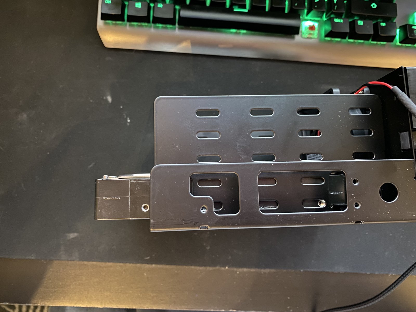

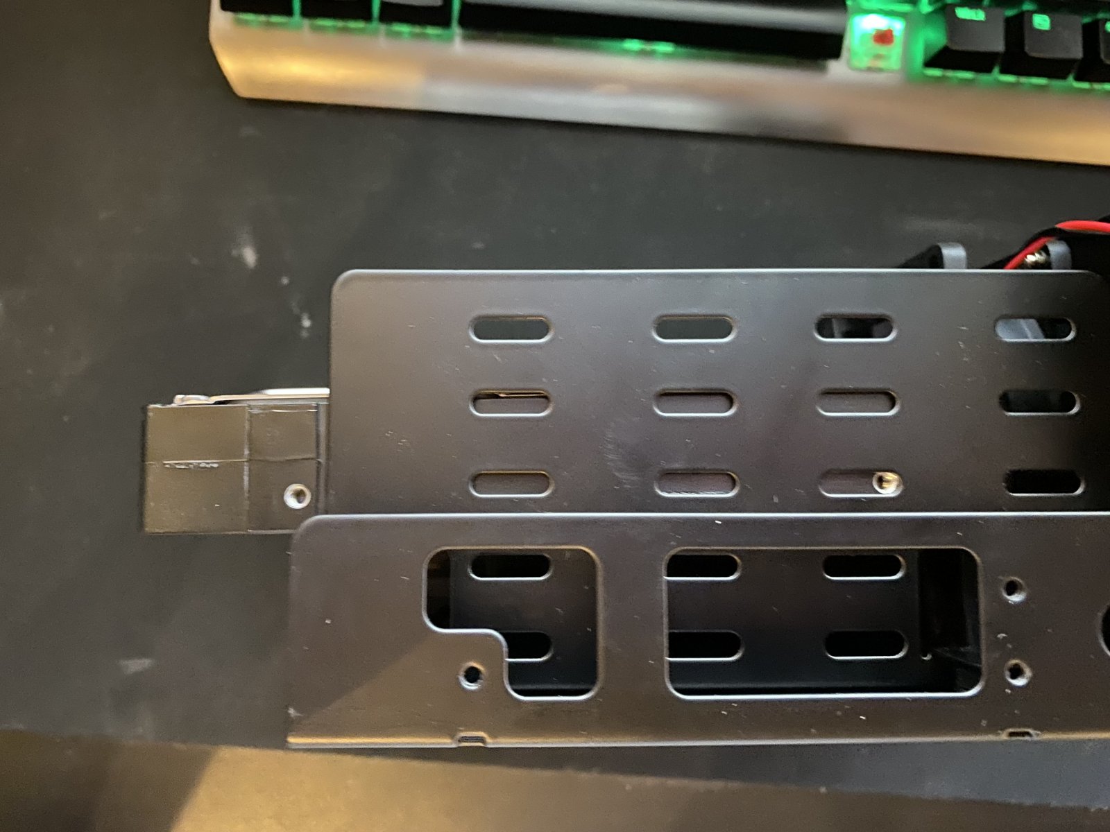

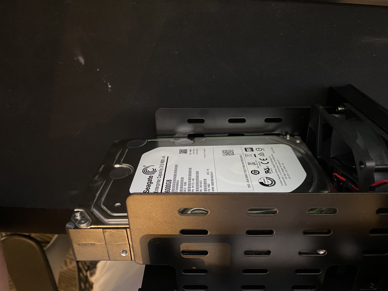

Bump, just noticed this on an some older Seagate ST6000NM0024 drives.
I got an Evercool 5.25 to 3x 3.5 converter, put the drive in and, what the heck, I cant mount these in here....^%$^%$^%$
Who thought this was a good idea?
Well, guess I won't be getting 2 more IronWolf's for my NAS build...
Good Job Seagate (one person noted they are doing this to fit the additional platters in the enclosure...)
