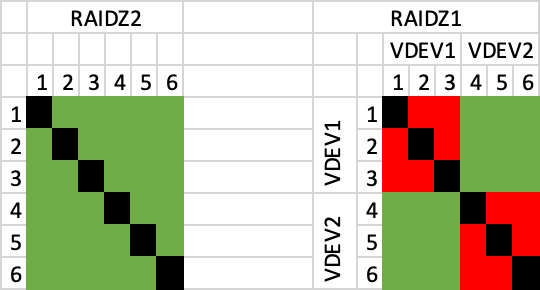

This rather crude diagram represents what I think pretty clearly:
If you lose 2 disks, the chances of pool loss are 0% in RAIDZ2, but are 40% for the 2x RAIDZ1 setup, so that's worth some thought.
Generally if you want IOPS, you need to use mirrors, so you'll want to consider that instead if you care about VM performance.
