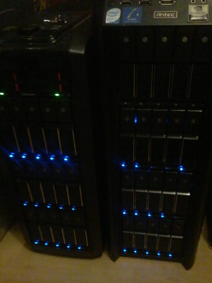

CraigD
Mar 8, 2016
343
I'm the guy using the MS800 (15 hot swap bays added and a drive hanging above the PCI-e slots) and an Antec 1200 case (20 hot swap bays)
The Antec 900 is still obtainable, bend up some of the tabs in the 5.25" bays and you can get 3 5 in 3 hot swap bays in it
Have Fun
