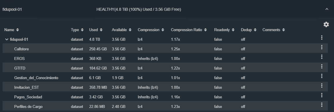

Good morning to all.
I'm having trouble with my freight service, and even though I search the net for some information, I can't get hold of the location of the snapshots.
In short, my problem is the following.
The snapshots consumed the disk space that I had available, and it is generating serious problems for me at the moment.

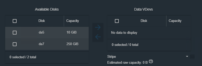

At the moment, I have only 3.5 gb available, I tried to perform the information reprocessing of some of the datasets, but despite this, there is no evidence that the available space increases. But when I delete snapshot logs, the available space immediately increases. I have tried several things, add a 250 GB disk, to try to add it to the pool, but I already have 5 1TB disks, and it does not allow me to add a 250 GB disk to that pool (I found in the documentation that it did not allow me .) I tried to clone the snapshots that occupied the most space, in a new pool with the 250 GB disk, but it does not allow me to clone them if they are not in the same volume.
The documentation is clear in saying that you can only add disks of the same size if you want to add space to that pool.
My idea would be to expand the unit where the snapshots are saved, or to save the snapshots on the additional disk I had, but I have not found how to carry out that process, how to tell the system to save the snapshots on a certain disk. I would appreciate very much if you could help me.

S.T.O.P!!! (Sit, Think, Observe, and Plan). Your data is in serious danger atm...
You are risking your server due to gross noobism. Snapshots aren’t stored anywhere other then where your data is.
3 GB on a 5 TB pool is 99.9..% utilization.. you will see performance degradation after 90%, and a warning after 80%.
snapshot don’t consume data per say, they prevent modified or deleted data from being wiped off the disk, so that it’s still retrievable.
also, you don’t seam to have any redundancy in this pool..
Your best bet now is to offload the data to a properly configured pool... I fear you won’t be able to import this pool if you reboot the machine.. it might work to import it read only, but I would not risk it. Build a new machine and a proper pool, then transfer the data over and rebuild this pool properly.

You need to find a way to get another logical copy of that data right now; from the looks of things, your pool is set up as striped (5x 1TB drives, 4.8T total) which means that any one drive failing will cause your whole pool to become inaccessible.
Whether this is a USB drive on a Windows machine or something else, you need to get a second copy right away.
Once that's done, start working towards the snapshot deletion to free up space - but your pool needs to be re-architected in a redundant manner.

Hello everyone, the solution I found was to add the 250GB disk to a new pool, and pass information there so that the server can continue to operate normally for a little longer, while debugging is carried out. I offer an apology for having written in Spanish, I did not expect so much show, but hahaha, thanks anyway. I learned a lot from your observations. Happy rest of the day.

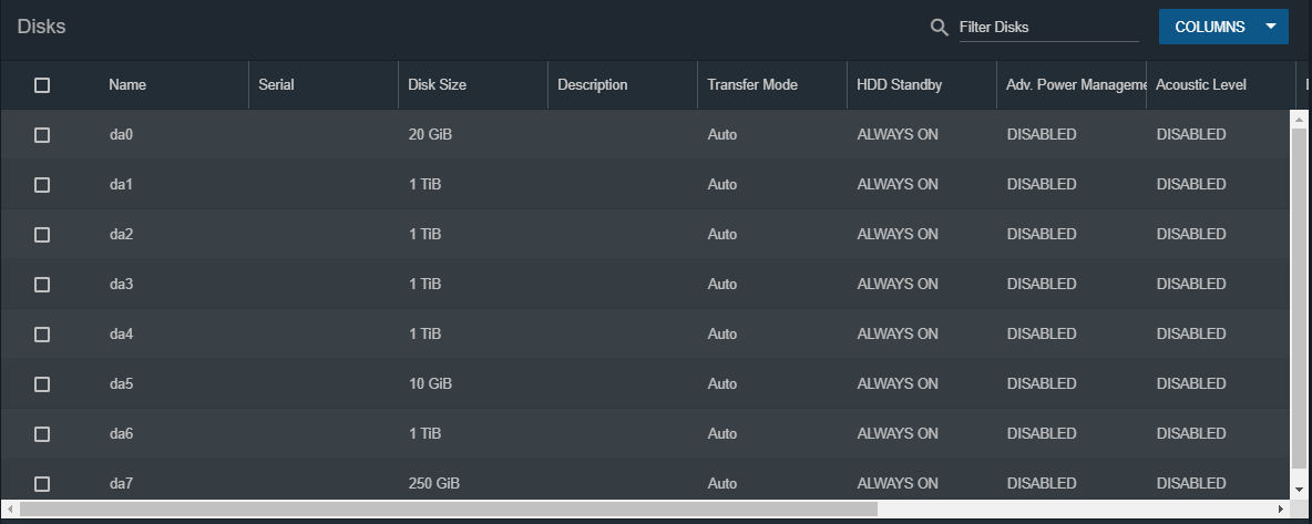

Hi danb35, ommm, I understand much better what you are telling me, the recommendation would then be to transfer all the data to a removable hard disk for example, and remount the server with RAID 1 or RAID 5.
(I have a question, how can I validate what type of RAID I have at the moment.)

15,504
You can see that on the pool status page in the GUI. If you let us know which version of FreeNAS you're using, we could tell you how to get there, or you can check the manual (use the Documentation link at the top of this page).

My versión is FreeNAS-11.2-U3.
Storage - Pools - (choose the Gear icon in the top right) Status
Post the screenshot there, but from your description and the total size you have a "RAID0" equivalent - all of your data is spread across all drives.
