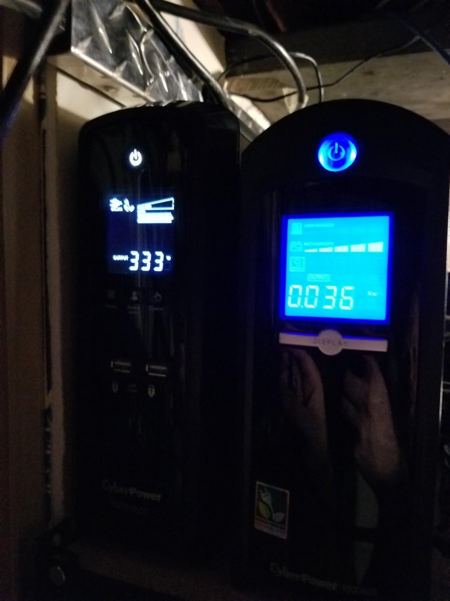

I currently have a CyberPower CP1500PFCD connected to my FreeNAS server and it works very well. Before that, I had an older CyberPower CP1500AVRLCD hooked up to my FreeNAS box that I purchased 6 or 7 years ago. After replacing the batteries in it a few months back, it has now been re-purposed for my pfSense firewall, switch and modem.

I have a CyberPower CP1500PFCLCD. I have my FreeNAS box, modem, router & switch plugged into it. No issues setting up the UPS service. It's rated to support Active PFC power supplies/Pure Sine Wave.
