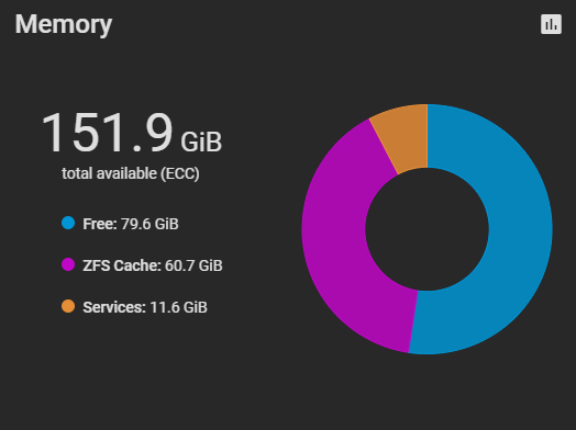

So I found I had ram in some servers that I was able to move over as well. I'm now doing testing again here the storage vmotions and the iometer tests don't really show any change. Here is what my dashboard shows. I do notice the ZFS Cache climbing quite a bit as the storage vmotion is going on. I think it hit up to 70G the vmotion finished and then it started to drop.

Well I'm not sure. I moved the SSD pool back to raidz1 across the 4 drives. Did the Storage vmotion. 4 min down from 20-30. Even though this is supposed to be "slower". IOMeter tests show the write speeds from 2-3 on the mirrored setup to now 17-18 on the raidz1. I guess I'll leave it this way. Have a couple other drives coming to test with. Non SSD 7200 RPM 8TB WD Red Plus. We'll see how they do in a mirror.
