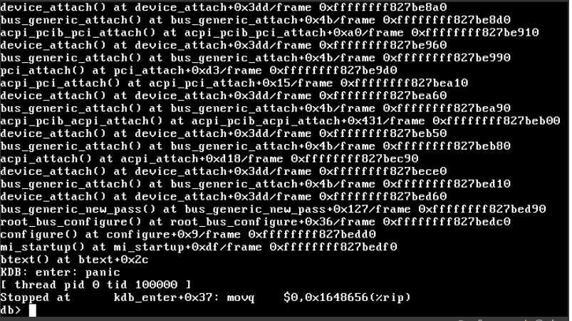

I have a HP Proliant DL380p Gen8 with 8 SAS 600gb on P420i controller.
Bios and smart array controller P420i controller is running latest firmware.
The P420i is running in HBA mode.
First i tried to install the latest TrueNas Core 12u7.
When I try to install i get this error message:
Then I tried to find a solution on this forum. One suggestion was to install TrueNas Core 11.0.
I was then able to install it, then I tried to upgrade to latest version 12u7.
After first reboot, I get the same error as above.
Could anyone point me in the correct direction how to solve this, and maybe explain me why it was working normally on version 11 and not 12?
