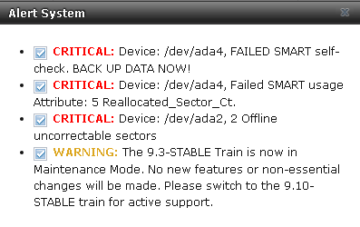

Today, I upgrade my freenas to 9.3.1 latest , the system show critical alert after reboot.
[root@160nas] /usr/local/etc# cat /var/log/messages |grep smart
Apr 13 00:20:03 160nas smartd[2586]: Device: /dev/ada4, FAILED SMART self-check. BACK UP DATA NOW!
Apr 13 00:20:03 160nas smartd[2586]: Device: /dev/ada4, Failed SMART usage Attribute: 5 Reallocated_Sector_Ct.
Apr 13 00:20:03 160nas smartd[2586]: Device: /dev/ada2, 2 Offline uncorrectable sectors
I check my pool , it don't have any problem,so what the message mean?

ada2 and ada4 are starting to have bad sectors. Usually a few bad sectors isn't a problem but if the number rise you'll want to replace the drives ;)
However as you have a RAID-Z1 you can't afford to have two drives failing at the same time so replace ada4 (as it seems in a worse state than ada2) before it's too late. I hope you have a backup of your data just in case.
The output of smartctl -a adaX for each drive would be useful to be more precise/confirm the answer :)
15,504
The messages mean exactly what they say: ada4 has failed a SMART self-test and has too many reallocated sectors, and ada2 has two offline/unreadable sectors. You need to replace ada4 immediately, and should keep an eye on ada2. There's no reason you should expect that this would show up in your pool status--it could, but it's also possible that the bad sectors are in locations with no data at the moment.

Hi danb35
If da1 smart test is normal , so I can ignore da1 error message from Web Gui (Alert System) ?
/dev/da1 [SAT], 2 Offline uncorrectable sectors
Two offline sectors doesn't (IMO) mean the drive needs to be replaced right away, but you should keep an eye on it. If the number starts climbing, you'll want to replace it.
Your last SMART results show the temperatures are lower, but still way too high.
Thanks your response .
The temperature issue I will improve it.
