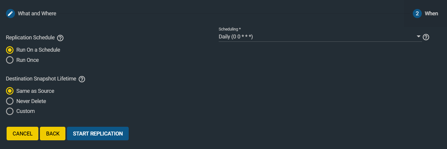

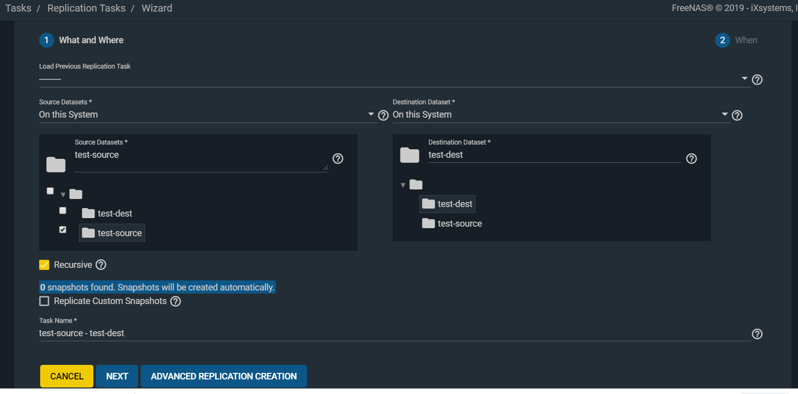

It's much more complicated than it ought to be, and I think I remember hearing that this will change with 11.3
Yep much better in 11.3:
I also see that you can change the lifetime. so you could do a 2 week retention on source and then keep for a month on the dest/backup server
