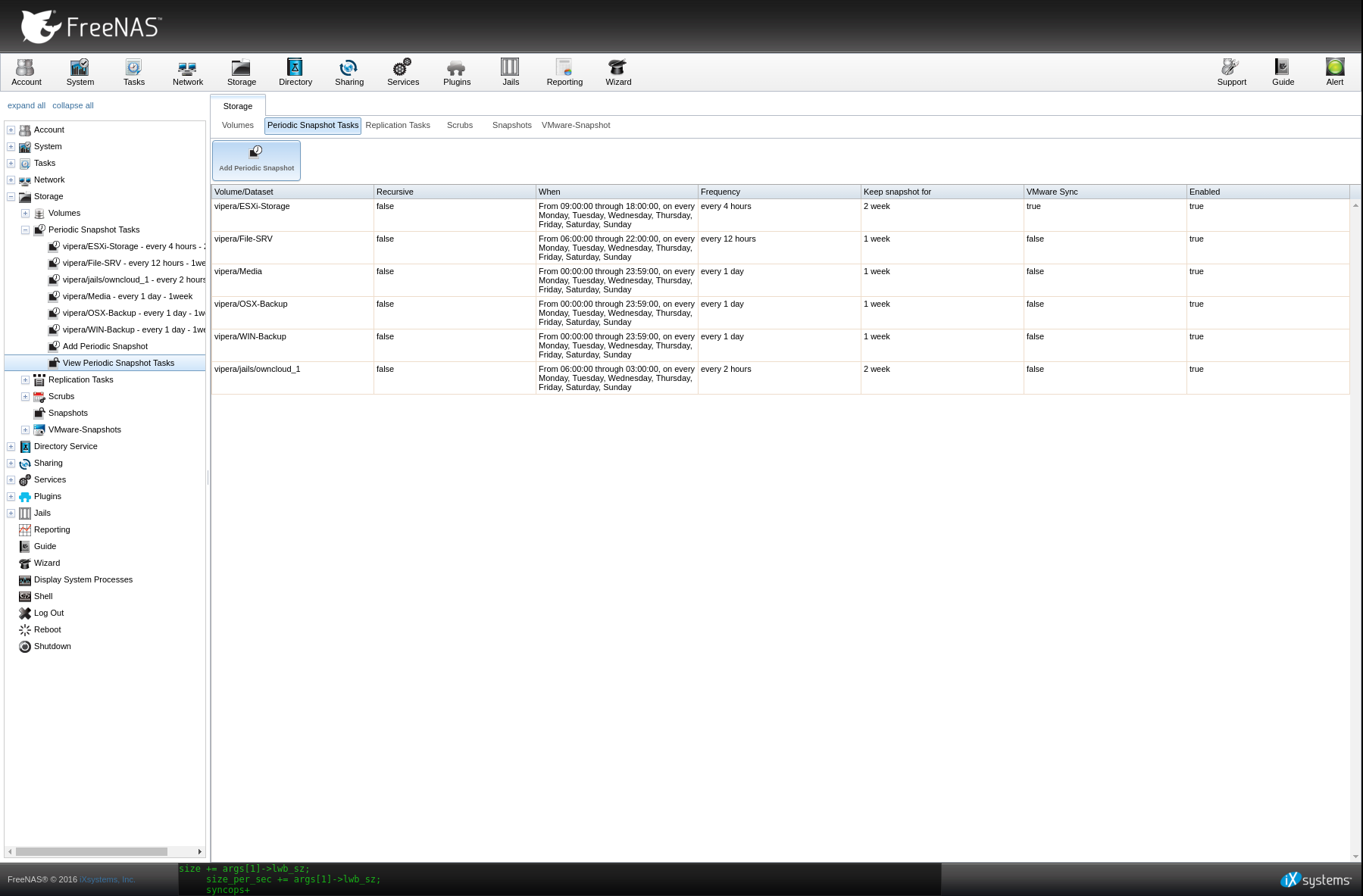

Can you prove a screen shot of your snapshot jobs and replication jobs? Do you have replication running on each dataset individually as well as a recursive one for the whole pool?

Of course i can, see below.
At the moment i only have individual replications running on each dataset and no recursive one for the whole pool. This seems to work, as since last reply i haven't got any more error messages.
This is the view of "Perodic Snapshot Tasks" on PUSH:
