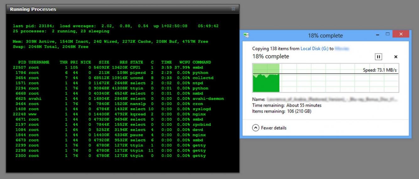

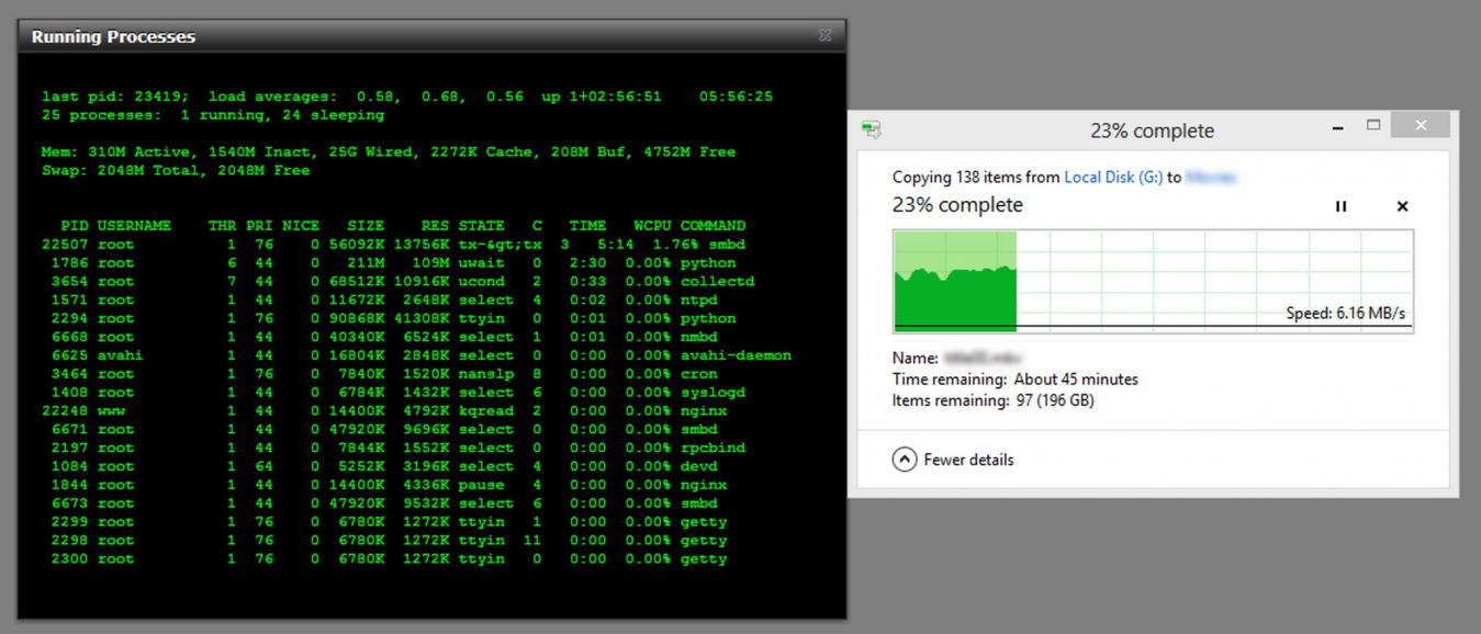

and why does it correlate with pauses in my large transfers to the FreeNAS? Here are two screenshots showing the transfer condition and the pause condition: Copy running.jpg Copy stalled.jpg . The transfer rate is excellent compared to the existing QNAP snail server, but it would be a lot better if it didn't pause half the time. My system is well cooled (plus it's freezing in here).

tx->tx is, I believe, transaction group flushing. IIRC it was primarily seen when the transaction group size was too big, which is consistent with "pauses". Your transfer speeds are probably a little "too good" and your disks are probably a little too slow. This is a variation of bug 1531 if so and could be addressed the same way.
