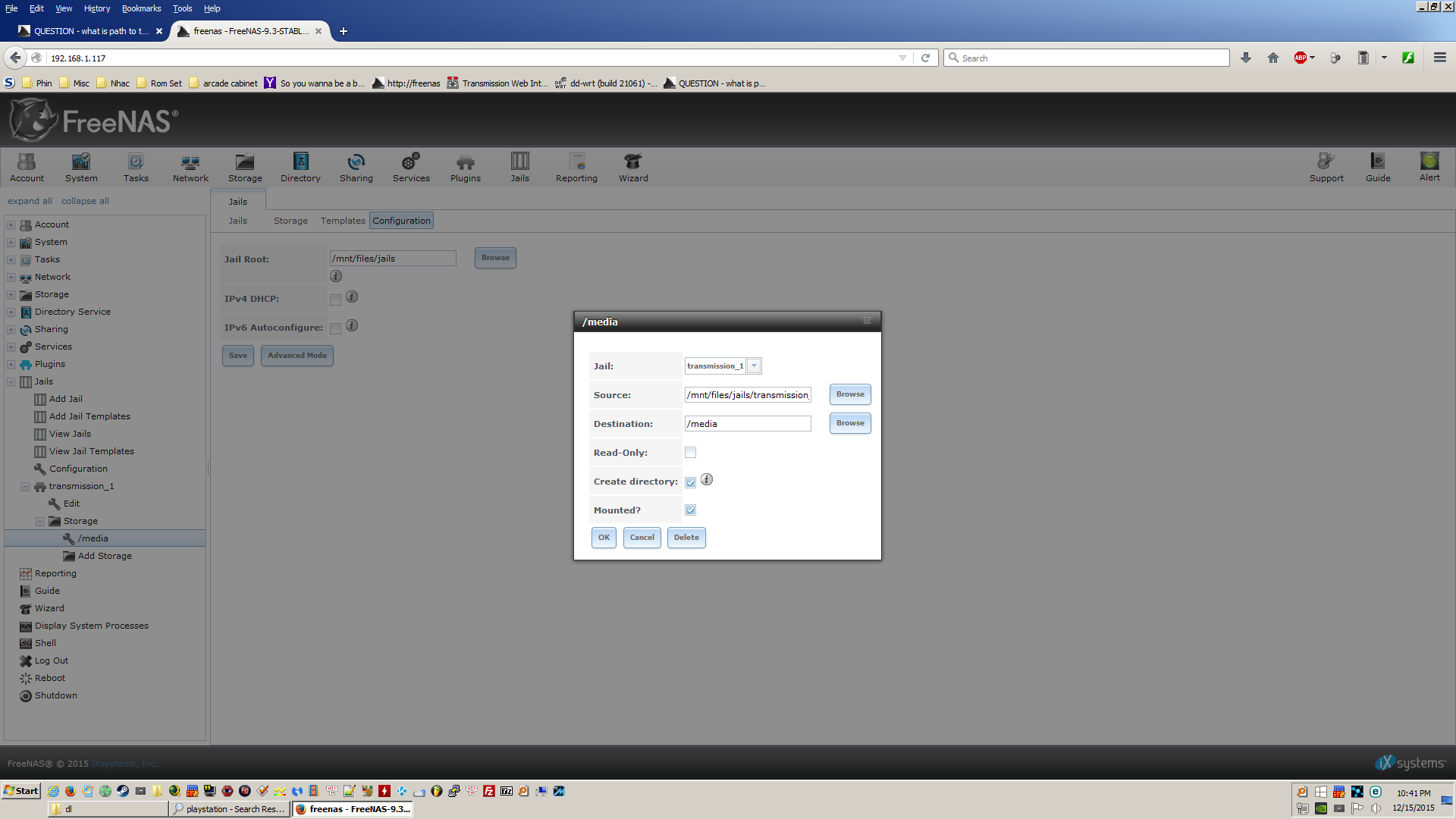

Please show a screenshot of your jail storage configuration for this jail.
You should not be mounting the jails dataset as jail storage. That's redundant.
You should have a 'downloads' dataset somewhere. add storage to the jail and have it be the source, and the destination will be relative to the jail root ('/'). I would pick /media/downloads as my destination.
Then in the jail, everything is downloaded to /media/downloads, and it is actually being downloaded to /mnt/files/downloads (the path on FreeNAS, not the jail)

ohh no..i changed the destination from /media to /Downloads....and now all my jail storage files can't be found..it's still there but idk where they went...they are no longer in Downloads folder nor media folder from screenshot
you're trying to mount the jail itself as storage to itself. This doesn't work.
http://doc.freenas.org/9.3/freenas_jails.html#add-storage
  • Source: is the directory or dataset on the FreeNAS® system you would like to gain access to from the jail. This directory must reside outside of the volume or dataset being used by the jail. This is why it is recommended to create a separate dataset to store jails, so that the dataset holding the jails will always be separate from any datasets used for storage on the FreeNAS® system.
  • Destination: select an existing, empty directory within the jail to link to the “Source” storage area. If that directory does not exist yet, type in the desired directory name and check the “Create directory” box.

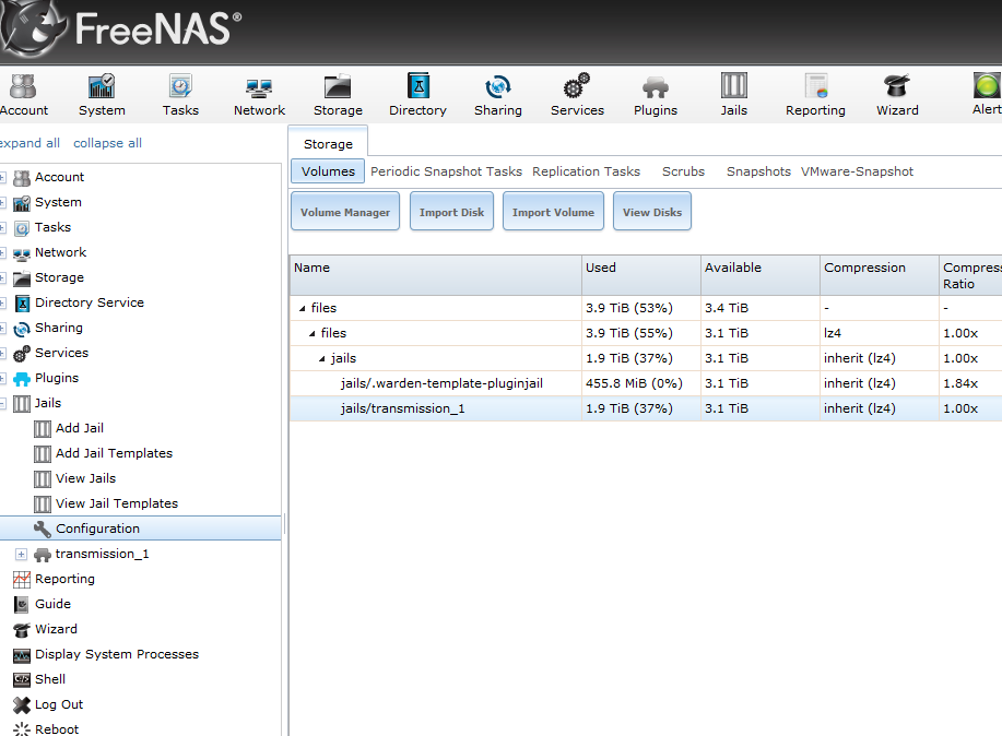

understood..but now..i just want to know where the files i had in my jail storage went....the 1.9 TB used..idk where the files are now...i tried searching for one of the files at the top level...nothing found

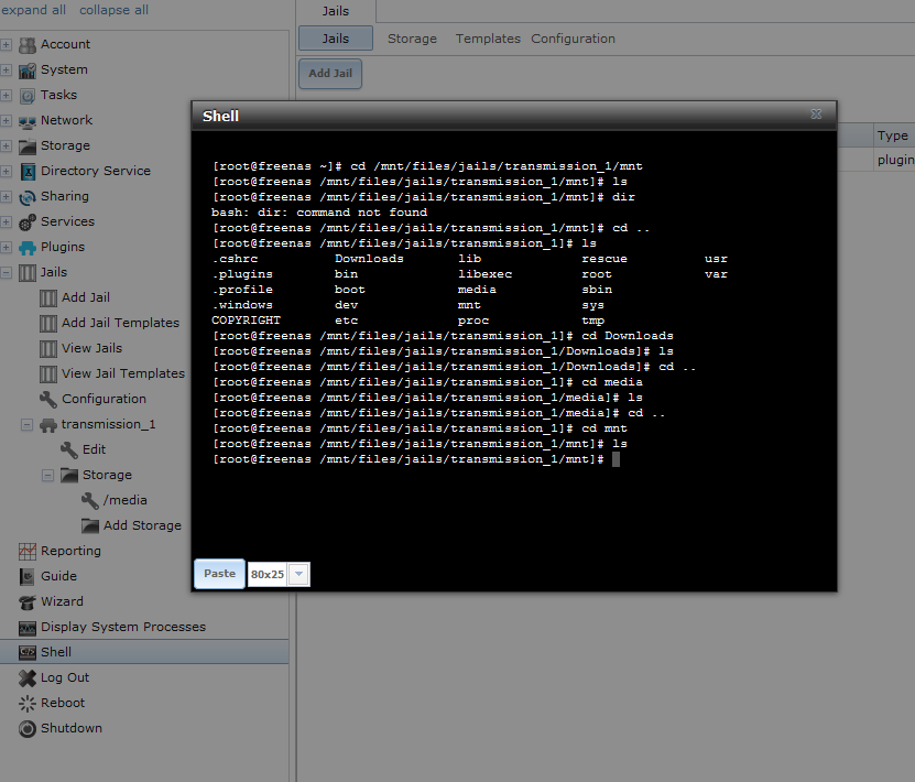

hmmm....from freenass cli: i went to /mnt/files/jails/transmission_1/mnt and did "ls" nothing showed up...even cd .. and went back into the folders, media, Downloads (where they files were)...

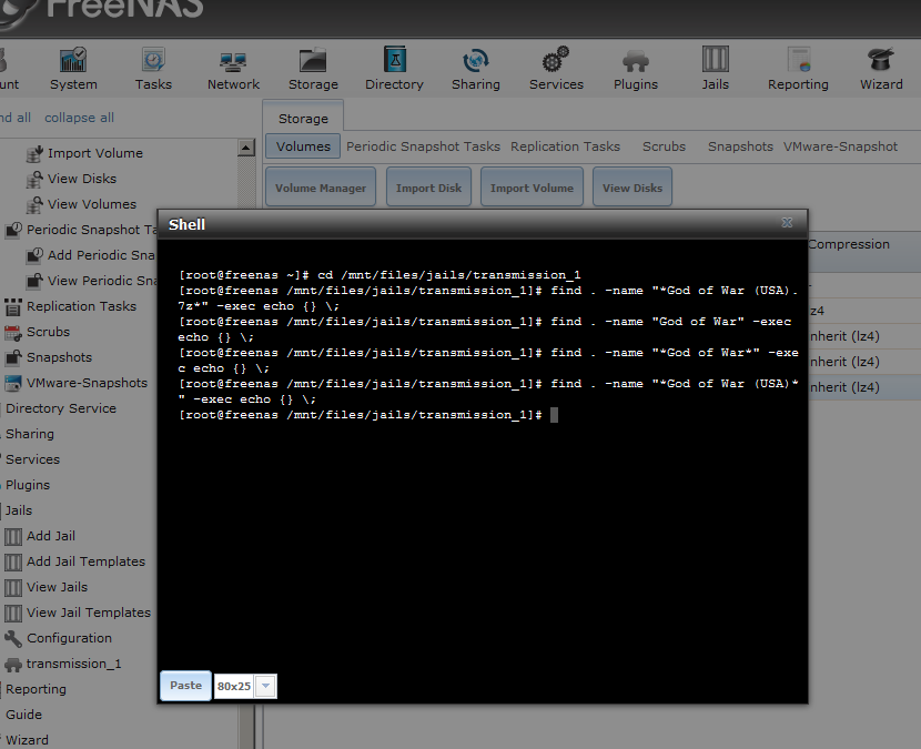

From FreeNAS cli,
cd /mnt/files/jails/transmission_1
Do you know the name of a file that is located in your downloads?
find . -name "*<nameoffile>*" -exec echo {} \;
It will print out the path of that file
Also, STOP USING THE CRAPTACULAR WEB SHELL.
Use SSH (PuTTy if on Windows, terminal if on Mac, any terminal emulator/shell on Linux)

yes, i tried searching for God of War (USA).7z not nothing was in result

You can try it from '/' instead of inside the jail path, but it my take a while depending on how many files you have on your server.

yes, thansk for the puTTY reminder..much better...i searched from '/' ...but nothing relevant showed up...am i screwed? i'm holding on to hope because storage says 1.9TB used....is it just hidding or something idk lol
