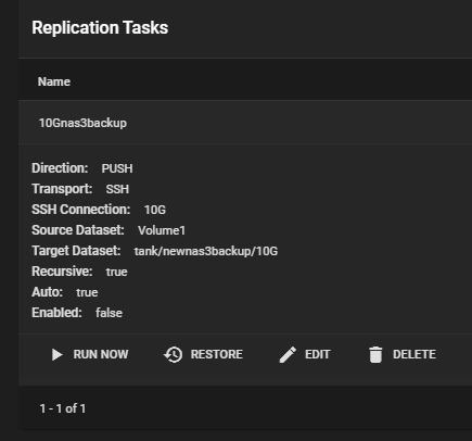

What does the "Restore" button do?
Redcoat
Feb 18, 2014
2,925
I have not been able to find a description of the function of "RESTORE" shown above.

Thanks, @Chris Moore . But that seems like a "radical" action not to be subject to qualification. Forgive me for looking to the devops for an authoritative answer.

Thanks, Chris. My apologies if my words offended...
I did RTFM - both the old and the new - before I wrote but didn't find anything about the Restore button (and the11.3-U5 manual has a pic of that GUI page that didn't have the button anyway). I need to take another look.

I can confirm that on my replication testing setup of TrueNAS-12.0-U8.1 the "Restore" button does exist, exactly as the OP showed, (however i have not tried TN v13.x yet, so cant comment on that version).
fwiw- in the case of PULL replication tasks, pressing the restore button gives you the option to "restore" it to a local pool (which usually is not what the user would be looking to do, as they would already have a local copy from the replication itself).
