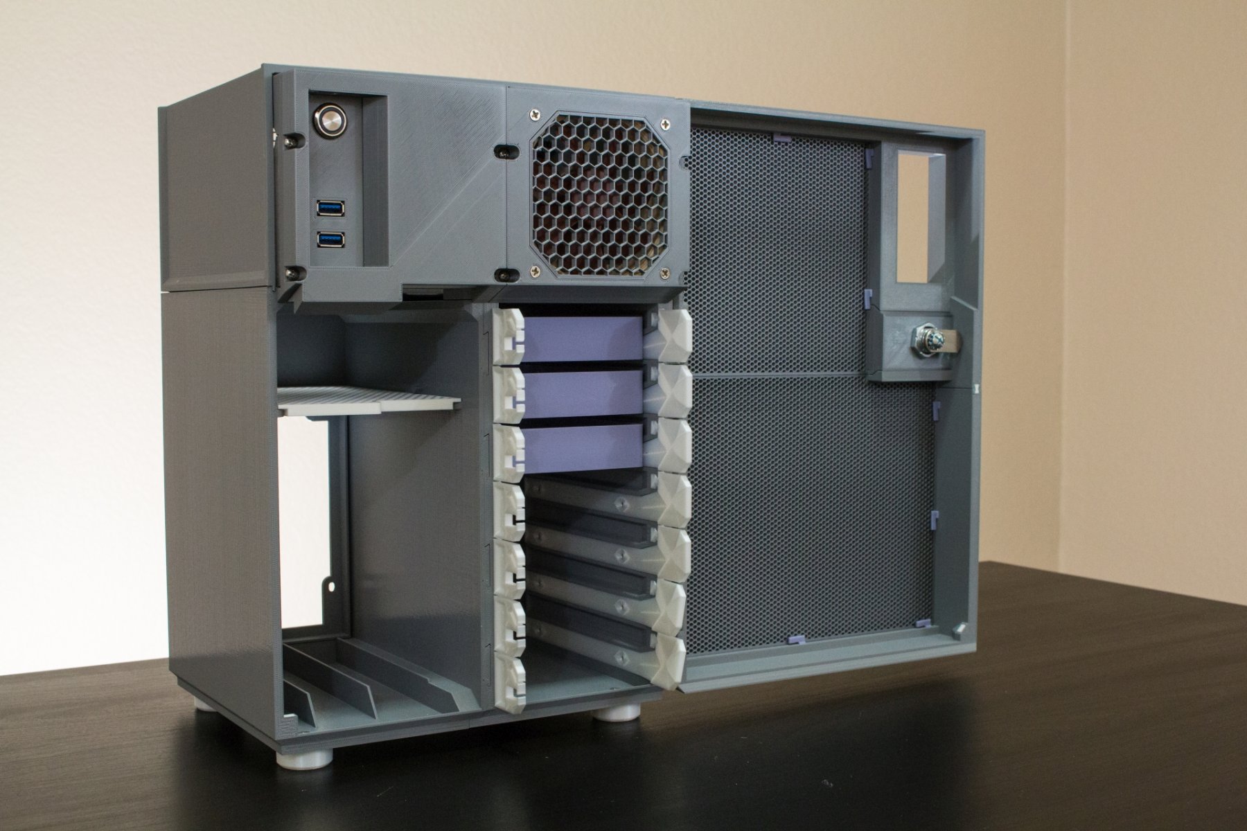

One of my blog's readers, Toby, reached out to me and asked "What about a 3D Printed Mini-ITX NAS Case?"
I get asked this pretty frequently between my NAS-related blogs and my own 3D Printing blogs, but I usually tell those people that the concept is interesting, but well beyond my meager 3D designing capabilities. But i this case, Toby had something else in mind, he wanted me to look over his 3D-printed NAS case and wanted to know what my thoughts were.
I'm normally a bit uncomfortable with self-promoting my content, but Toby's case was impressive enough that I've been sharing this a few places I thought people might be interested in it.
Here's a few photos:

That's really amazing. I wish I had the skills to draw these kinds of things - my education stopped at AutoCAD 2D. Congratulations!
I'm surprised the passive heatsink suffices, however.
If I were making a case like this for a NAS, I'd consider a different design from what we usually see. The HDDs would be arranged on side in the bottom using LIAN LI backplanes. Air would be pulled up via 3 120mm fans pointing up. The Flex ATX board and PS would be installed one level up. Two funnels would lead to the board from 120mm fans mounted in the side perimeter - one for the CPU, one for the SAS chip (LSI 2116). Then another set of fans would pull the air up and out of the enclosure. I'd consider having the "controls" on the same side as the I/O backplate, putting the PSU on the "front" instead.

I wish I had the skill, too! This is actually from one of my blog's readers and it's really quite amazing. However, I would encourage you to check out something like OpenSCAD. I think you'd be surprised at how easily you can start 3D designing things. I personally have 3D designed quite a few things and printed them to solve problems myself, it's really interesting.

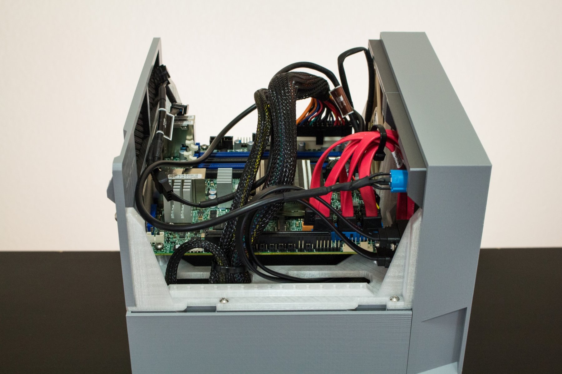

It doesn't, for sure for this particular motherboard (Supermicro X10SDV-4C-TLN2F ). It just happened to be the only Mini-ITX motherboard I had laying around--it's only in there to test fitment and see how the case works. However, having crammed quite a few passively cooled CPUs (mostly Denverton/Avoton CPUs) into even similar-or-smaller cases, I wouldn't hesitate doing the same in this case.
Impressive stuff, no doubt. My main worry is that some components may be a little too fragile over the long term, particularly around the screws. I might have missed it in a quick read-through, but I'm curious about how the structural screws attach to the 3D-printed parts.
One disadvantage I see is that some combinations of environment and components might need some EMI shielding for things to work well, which would mean covering the panels with some metal foil or paint or something. I imagine most users wouldn't have to worry, particularly if the SATA cables (which are the only really high-speed cables you'd find in a server like this, apart from USB) are kept as short as possible.
It's not something I'd considered before, but 3D printing might actually be the answer to the search for the mythical compact small server chassis with good airflow.
Something like this, but symmetric and with fans at the top?

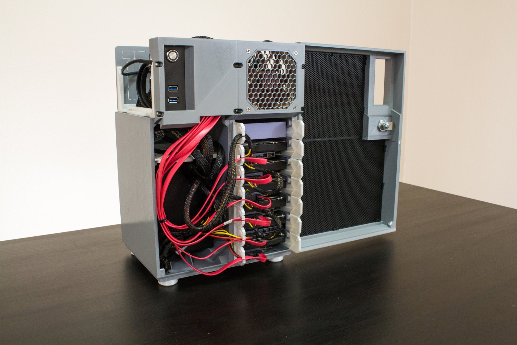

I share @Constantin's conservatism on cooling having suffered a cooked Avoton in a small case. I actually wondered about the drives and their cooling with the subject case here - what's promoting air flow through their stack in this design?
There are fans at the rear, the linked blog post has more pictures.
