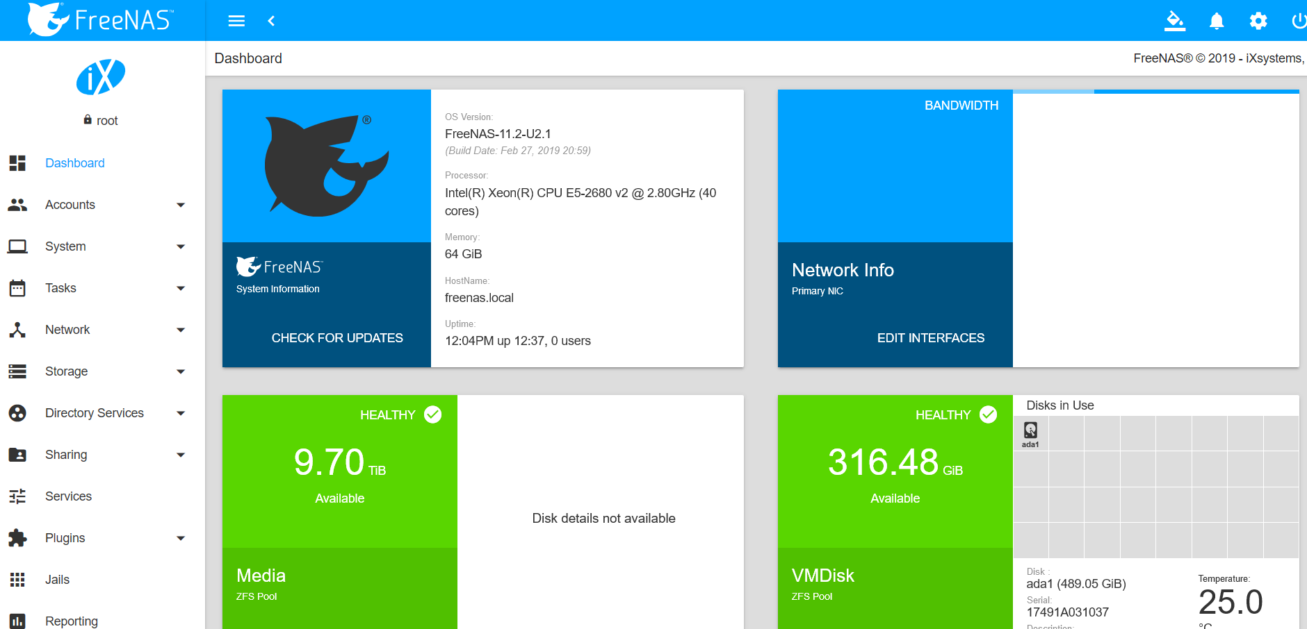

First, in the new UI, the dashboard routinely will not load some tiles. but sometimes they load. but it never seems to load all of them, only some.

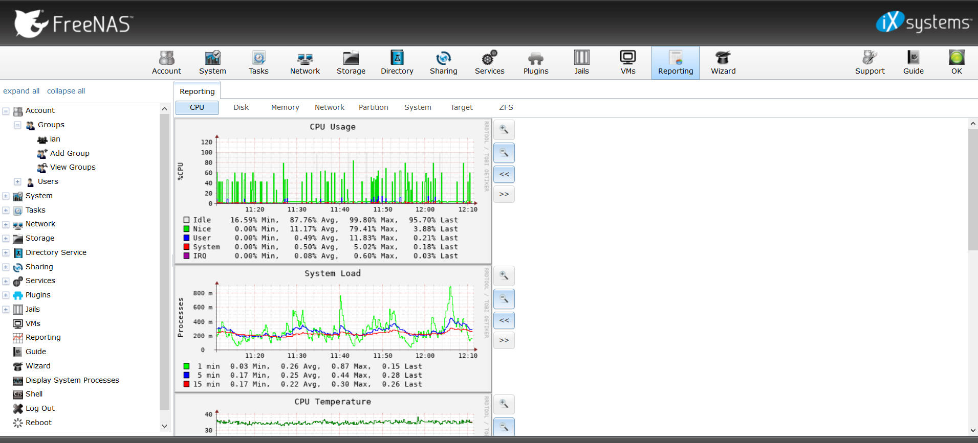

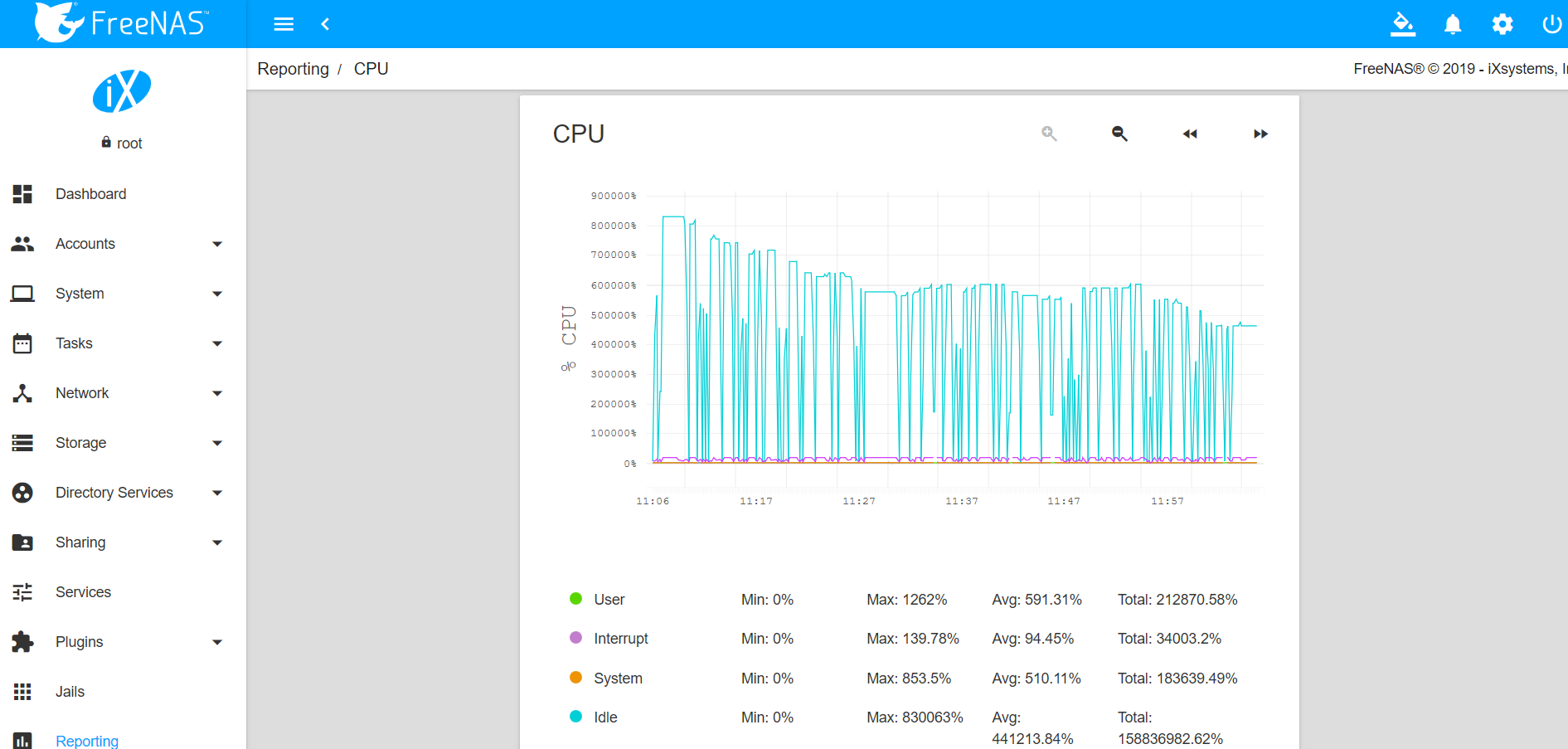

Second, the CPU use numbers are way off, I'm seeing values like 1000000%, and there's no where to see CPU temp other than the dashboard widget that never loads. but if i switch to the Legacy UI, the CPU values are at least under 100% and i can see CPU temps there, but i'm seeing more activity than usual on the idle system. "pings" up to 60-80% when this never happened before with the same setup.

The most likely answer here, just based on what I am seeing, is that the new UI is having trouble parsing the data it is getting from your system and showing results that don't exactly make sense, or showing no results at all. To me, it looks like a bug, and it could be fairly specific to the quantity of cores you have. I see the system is reporting 40 cores, and I know that the Xeon E5-2680 v2 is a 10 core, that makes the system a dual socket unit, with hyper-threading. Still, knowing the exact hardware might be helpful, but I am thinking this is just a minor bug in the new UI. Have you setup an account on the https://redmine.ixsystems.com/projects/freenas/ site?

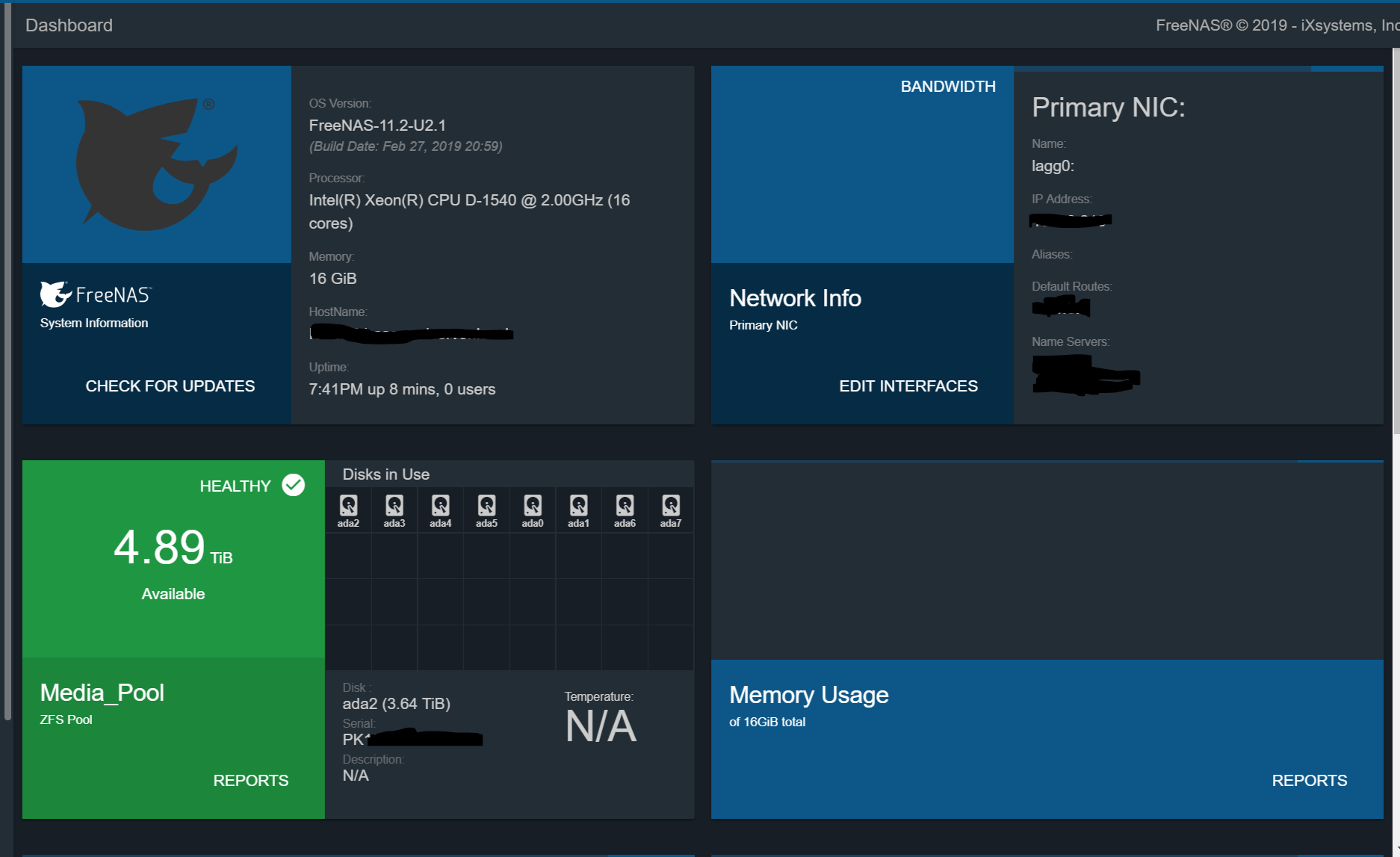

Same Here:
11.2-Release-u2.1
ASRockRack D1540d4i
2x Kingston 8GB 288-Pin DDR4 SDRAM ECC Registered DDR4 2133MHz
8x Hitatchi DESKSTAR 4Tb 7200rpm
Netdata works just fine, ever stat works and appears accurate. The reports section appears to match netdata; just the dashboard that doesn't work.

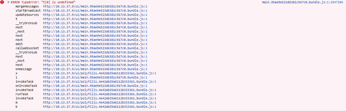

This seems like a javascript error in the new UI, i'm getting this error in the console :

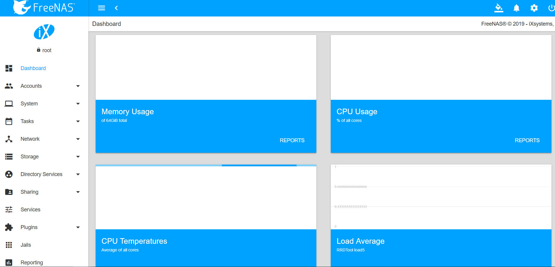

I have same problem, but it only began when I moved my system over to ESXi from bare metal today. Maybe it's a different problem.
