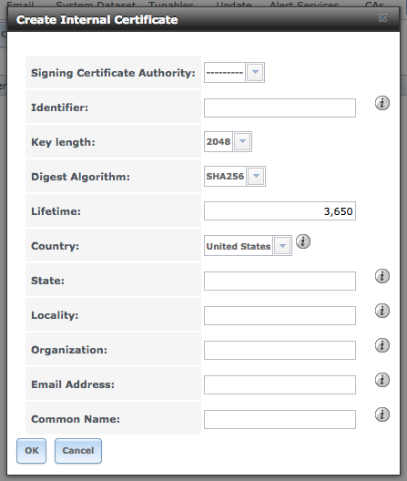

q_fleuren
Jun 3, 2015
57
This error means that the hostname you're trying to reach in your browser doesn't match the hostname(s) on the cert presented by your server. Starting with version 58 of Chrome, Chrome doesn't look to the Common Name field of a certificate, it looks only to the subjectAlternativeName field (see https://support.google.com/chrome/a/answer/7391219?hl=en). So, you'll need to generate a certificate with the hostname/IP in that field. Certificates generated by Let's Encrypt do this automatically.
Watch the stars
In cert ip is given as common name
Or should both ca and cert common name be ip?
15,504
The CA common name doesn't matter. But the cert needs to have the IP (or hostname--whatever you're entering in the browser's address bar) included in the subjectAlternativeName field as well. It looks like FreeNAS 11 supports this field (https://bugs.freenas.org/issues/23844, https://bugs.freenas.org/issues/23130), but 9.10 does not and won't (https://bugs.freenas.org/issues/24370). However, the manual (http://doc.freenas.org/11/system.html#certificates) doesn't indicate that the SAN field is available as it seems it should be.
Which version of FreeNAS are you using?
q_fleuren
Jun 3, 2015
57
Sorry for my delayed reaction,
I'm using FN 9.10 U5
Waiting with upgrading to 11 because coral..
15,504
From the bugs I linked above, it sounds like:
  • 11 automatically includes the commonName in the SAN field, and
  • That feature won't be backported to the 9.10 series.
So, either you can not use Chrome, you can upgrade to 11 and generate the cert there, or you can manually generate the cert using some other means that will include the SAN field.

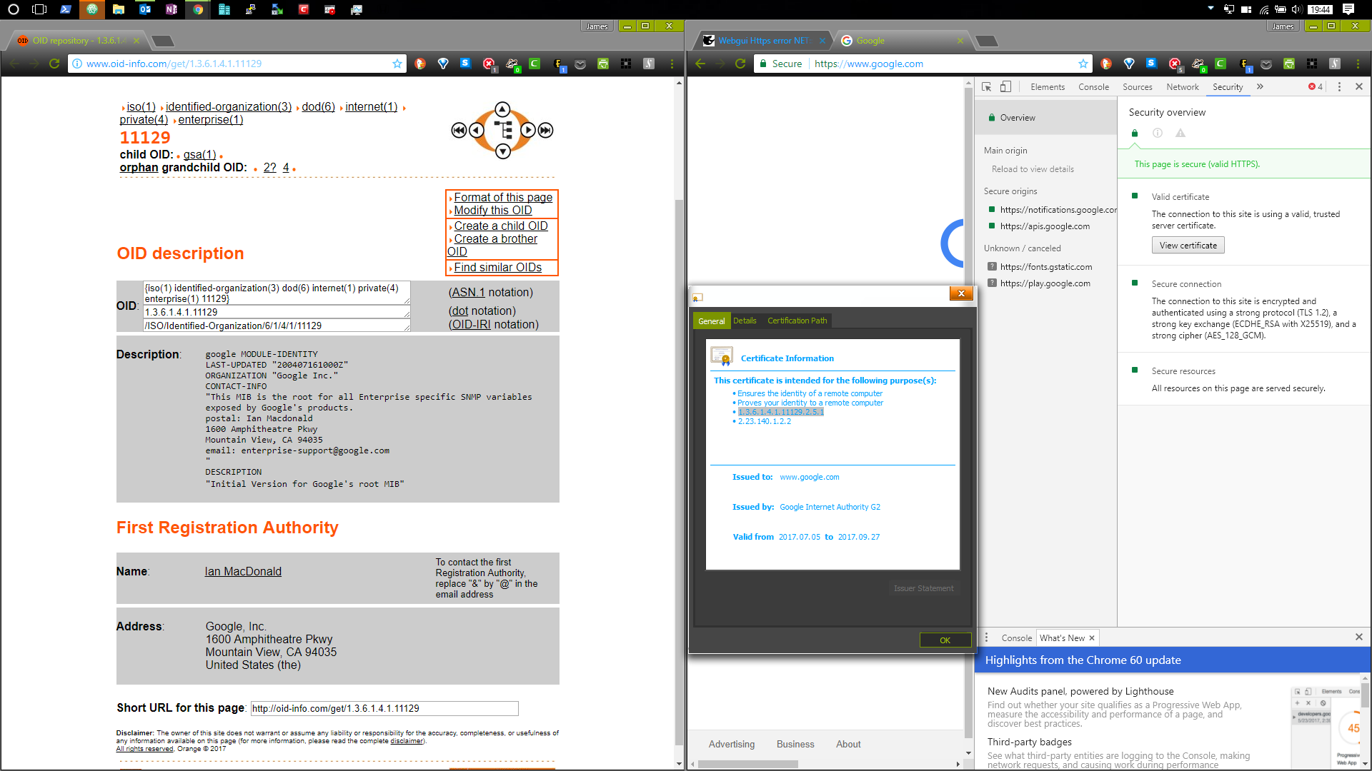

The IP address used in the IP options can be in either IPv4 or IPv6 format.
The value of dirName should point to a section containing the distinguished name to use as a set of name value pairs. Multi values AVAs can be formed by prefacing the name with a +character.
otherName can include arbitrary data associated with an OID: the value should be the OID followed by a semicolon and the content in standard ASN1_generate_nconf(3) format.
OIDs alone are endless, can be combined to create new OIDs (see OID Database), and almost all WAN certs from professional CAs/ICAs are issued with OIDs as apart of their SAN profiles. I've attached a screenshot of Google's SSL cert, which has two OIDs (1.3.6.1.4.1.11129.2.5.1 & 2.23.140.1.2.2)
