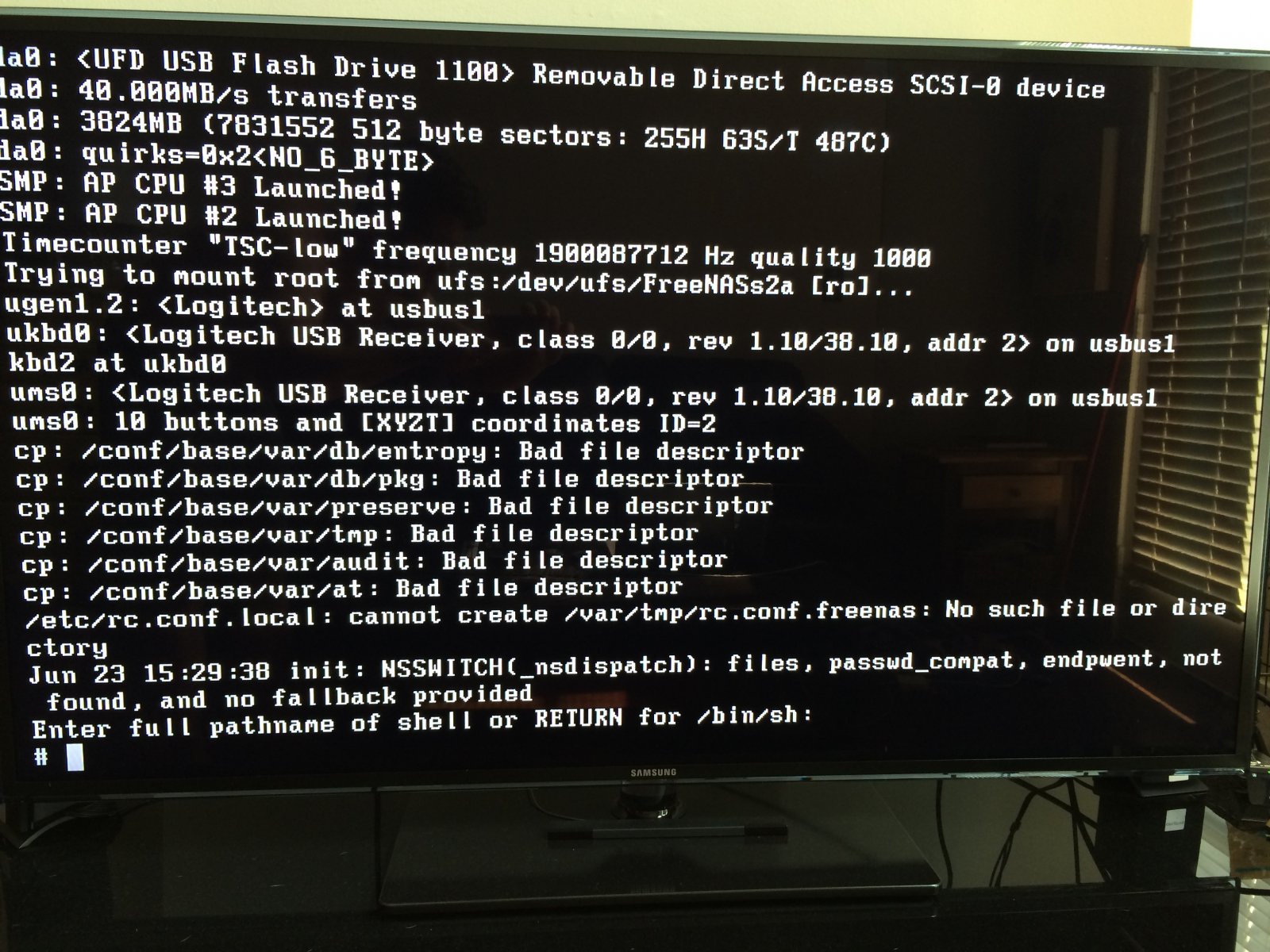

I received an error that the Web interface was unavailable and got a message from nginx.
I tried rebooting my system and now I am getting an error at startup. See attached. Any help would be appreciated.
crisman
Feb 8, 2012
97
Probably you have a bad/corrupted flash drive.
Do you have a backup of your freenas configuration?
Can you install freenas on another flash drive and restore the configuration?

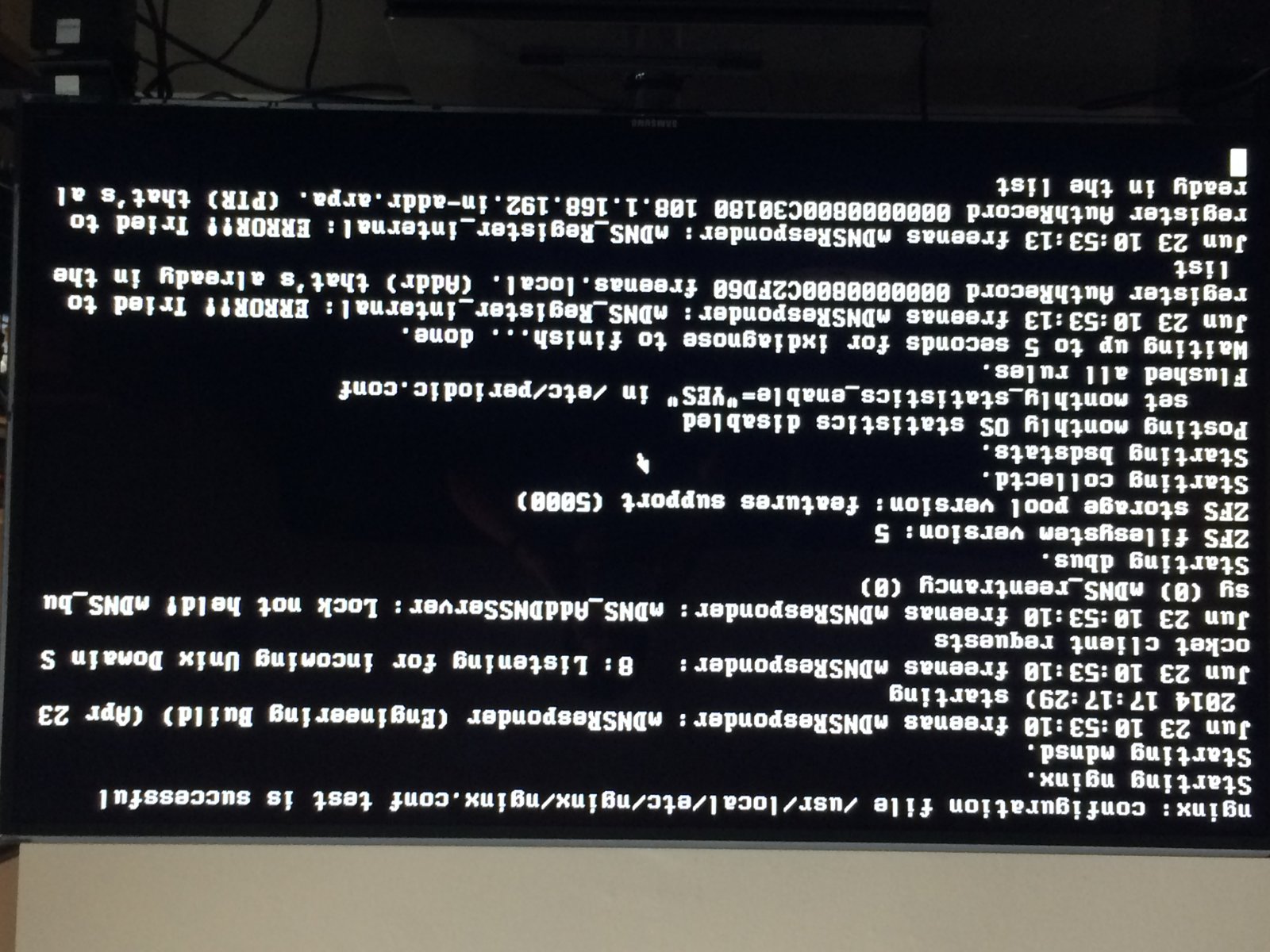

TexasEx
Nov 8, 2013
20
I just loaded 9.2.1.5 on a new USB and I am not getting anything at the web interface when I hit my IP address.
I also received the attached message for a few minutes before I got to the main menu on my first boot up.
Whattteva
Mar 5, 2013
1,824
Lol, you should fix the orientation of that screenshot. I had to flip my monitor to read it. Not everyone is going to have the luxury to do that.
solarisguy
Apr 4, 2014
1,125
The message shown on the screenshot is not important. Can you login on the console and check /var/log/messages ?
Are you connecting to your FreeNAS from the same subnet (i.e. no routing/gateways involved)?
