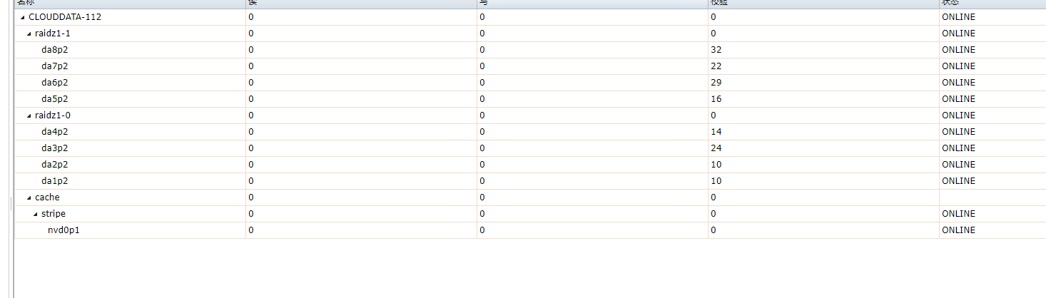

hi,
please help me see image.
before we found freenas no use. check HBA card bad and system os disk same bad.
now we change new HBA card and new os disk.
but very read/write slow.
and maybe have error
2019年7月9日 19:47 - 卷 CLOUDDATA-112 状态为 ONLINE: One or more devices has experienced an unrecoverable error. An attempt was made to correct the error. Applications are unaffected.
so this is disk bad?

I don't see error on your pool on the above picture.
Try run
smartctl -t long /dev/daX
for each disk and post results.

your pool has a bunch of checksum errors and looks like you might have multiple disks failing. You didnt' setup smart tests or you would have gotten emails about this. Go setup emails and smart tests then run smartctl -t long /dev/daX for each disk. Post the output of smartctl -a /dev/daX for each drive also. You should back up your data and get ready to replace drives.

you see we first image. i see all disk maybe have trouble. just issue hba card bad.

xmbillion
Dec 16, 2018
16
What are the values for
5 Reallocated_Sector_Ct
197 Current_Pending_Sector
198 Offline_Uncorrectable
199 UDMA_CRC_Error_Count

608
Hi, please send the output of smartctl -a /dev/{device}. The above looks like just a summary.
It looks like the drive is a SAS drive and not a SATA one. SAS smart data looks that way. Although it looks the vendor information has been cut, so the first ~10 lines of the output are missing.
Oct 18, 2018
969
Ah yeah, thanks. I scanned too quickly.
Non-medium error count: 18
These point to possible issues with cables or the controller. Check out this forum post or this smartmontools page. It looks like your drives don't have any `Total uncorrected errors`, this is a good thing. It looks like possibly all of your drives are reporting some Non-medium error count? If that does indeed indicate a communication issue it might be the controller rather than a cable.
Perhaps someone else has better ideas though.
