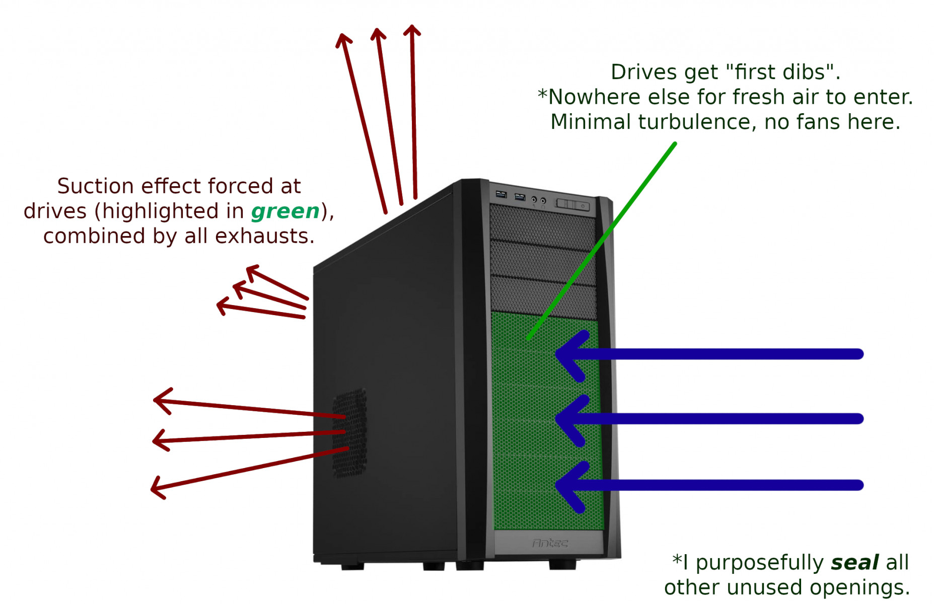

I believe focusing airflow (via negative pressure at specific areas of the chassis) yields better and more consistent cooling effects of the drives than attempting to position a case fan to blow directly at the drives; let alone a mixture of inlets and exhausts.
Some time back I started to only use exhaust fans: no inlet fans (i.e, no fans are blowing air into the case). I'm very likely going to keep using this method as I found it gives the most favorable results. I'll later attach an image to further explain why.
Oct 22, 2019
3,641
Here's my general rule-of-thumb that I use, not only for a NAS server, but for custom PC builds in general. The case, used as an example in the image, is for illustrative purposes only. It does however emphasize that there should be a grille or mesh (where fresh air can enter), and that this part of the case should be where your drives / bays reside. No need for any fancy bells or whistles; simple principles with tried-and-true results. This type of setup has consistently kept my drives at ideal temperatures.
