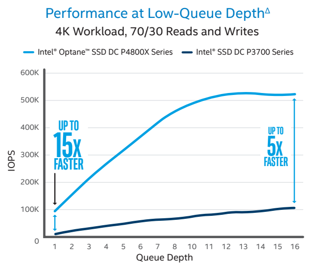

"You're missing something." Optane doesn't have the ability create multiple NVMe namespaces, so the total write bandwidth will be shared between the SLOG and special partition via the QoS method of "Thunderdome" - it's just going to be a battle, and I/O will likely be inconsistent as a result.
As an additional note, for small-block writes the Optane that much faster than the P3700. Optane only starts to run away from a 400G P3700 beyond 32K based on the SLOG testing thread:
upload_2018-9-12_15-10-10-png.25645
(If it doesn't load, it's from this post - https://www.ixsystems.com/community...inding-the-best-slog.63521/page-4#post-481734 )

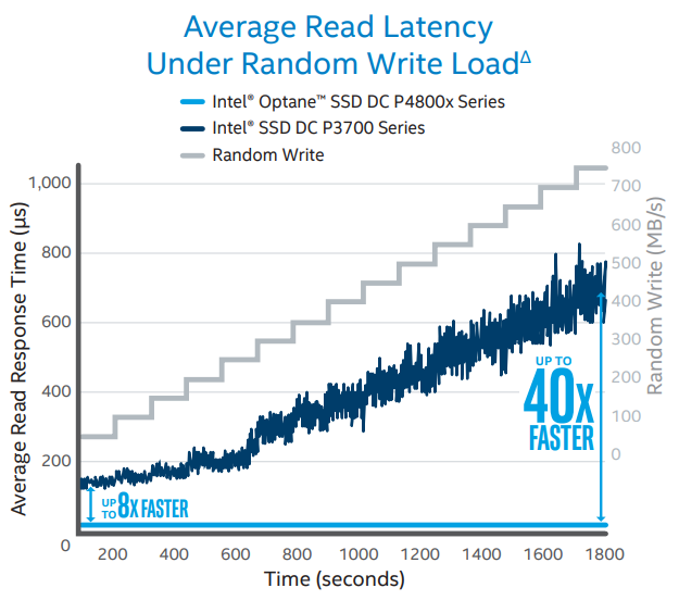

For information, I saw that post, and a few others. What I'm reckoning is mixed IO - reading metadata/spacemaps/DDT, but also updating them. Possibly with usual ZFS write amplification (tree block checksums, spacemaps, copies, etc). But even Intel's datacentre SSDs have historically not handled sustained mixed loads well. This review (Tom's Hardware) looked at Optane vs highly reputed SSDs such as Samsung 960 Pro (enthusiast) and Intel 750 (datacentre).
That's what motivated me to Optane...... not the simple 4k random read, or 4k random write latency/speed, but the lack of plunging performance under mixed loads.

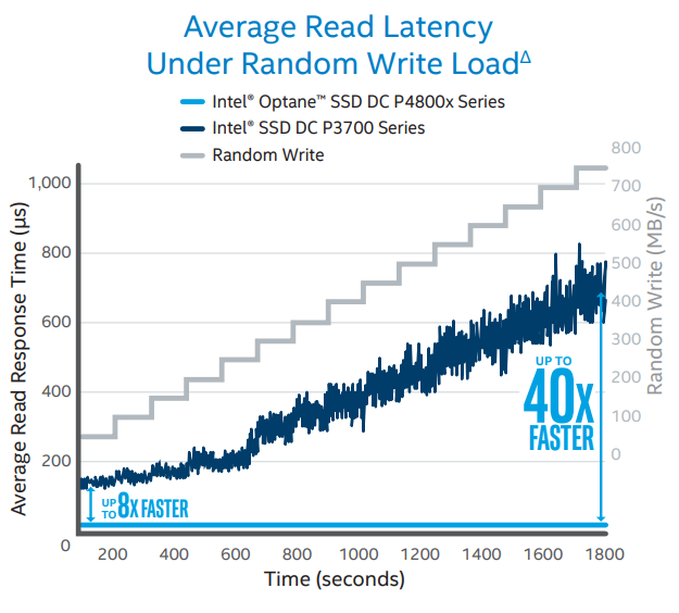

That's one sexy linear relationship. It is geared towards "sequental mixed" rather than "random mixed" but I imagine that will only change the scale/scope of the results given Optane's ability to handle small-block and shallow-queue.
Some further backup can be found (and taken with a grain of salt, since it's from Intel themselves) in this whitepaper showing a comparison of the regular DC P3700 vs the Optane DC P4800X in a vSAN mixed workload (70/30 R/W split):
https://media.zones.com/images/pdf/...orage-increases-performance-solutionbrief.pdf
Relevant graphs have been snipped and pasted below:
And while we already know how good Optane is at writes, a little extra reinforcement for how good it is at continuing to provide good reads while under writes:
Optane could well be the exception to "don't split a device between read and write workloads" - even with no namespaces and an "every I/O for itself" QoS it seems to do extremely well.
I hadn't seen those graphs/sources! Thank you!

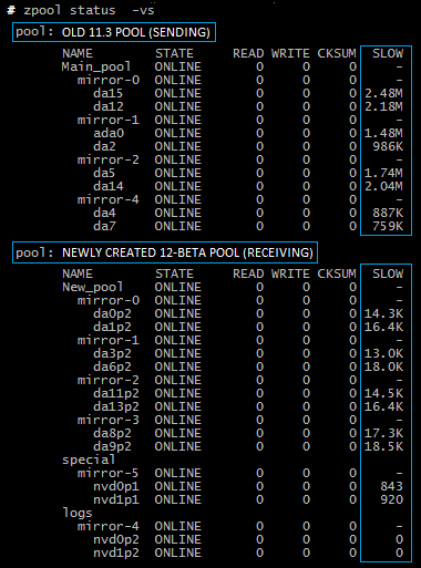

Also this dump, taken 28 hours (24 TB) into a 35 TB send/recv replication between my 11.3 pool and a newly created 12-BETA pool on the same machine. The 12-BETA pool is using mirrored optane special vdevs for metadata, and is dedup as well as the original pool.
Notice the hugely different latencies. I've configured it to treat any disk I/O that takes longer than 200 milliseconds as being "slow" (sysctl vfs.zfs.zio.slow_io_ms=200). It's a good way to find drives that are being queued up so much that they can't respond quickly, and how often it's happening.
  • The pool being *read* was created under 11.3. Its hard drives have typically reported around 0.8 - 2.4 million slow access events.
  • The HDDs in the newly created 12.0 pool are exactly the same model of HDD. They are also 2 way mirrors, although 4 not 3 HDD vdevs. But they are writing which is typically quite a bit slower than reading. They also have full use of the OpenZFS 2.0 tunables, features, and special vdevs for metadata and dedup. (both pools are fully deduped). We can allow that they have fewer accesses, because they can be written in large chunks not piecemeal laid down over time. After allowing for all of those, the OpenZFS 2.0 pool has a typical "slow access" event rate of about 13-18 thousand per device.
  • The special vdevs in the 12.0 pool are reporting just 900 slow events, or ~ 6% of the HDD slow event rate in that pool. That's despite handling all file and pool metadata, and all dedup data. (Although a lot of that is cached in ARC so it doesn't need reading back as much)
Short version, the 12-beta HDDs were "slow" (>200 ms) for disk I/O at about 1% of the rate that the 11.3 pool is doing. Because it's reporting total event counts, it also confirms they are running a lot more consistently low rates regarding latency, not just running at low rates.
Also a mass recursive delete of 957 snapshots, across 17 datasets (16269 snaps total) just took 48 minutes - dedup snap destroy rate down from tens of seconds per snap, to 1/6 of a second each.
That gain is almost entirely down to one reason: the metadata and dedup tables have been offloaded to a fast SSD vdev in 12-BETA, which can't be done in 11.3 or earlier.
