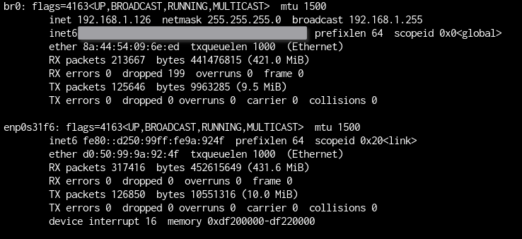

Hi, I am currently trying to implement wake on wan to be able to turn on my backup server from outside my lan. Wake on lan works when using the nic's mac address but my router sees my truenas only by the bridge's mac address. So I am currently unable to redirect my wol packets using the static ip because it is bound to the bridge's address which doesn't support wol.
I know my problem is quite specific and not a recommended use-case but is there a way I could configure this to be able to achieve wake on wan ?
Here are the interfaces :

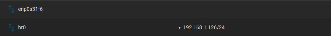

The physical nic is marked as offline without ip:
