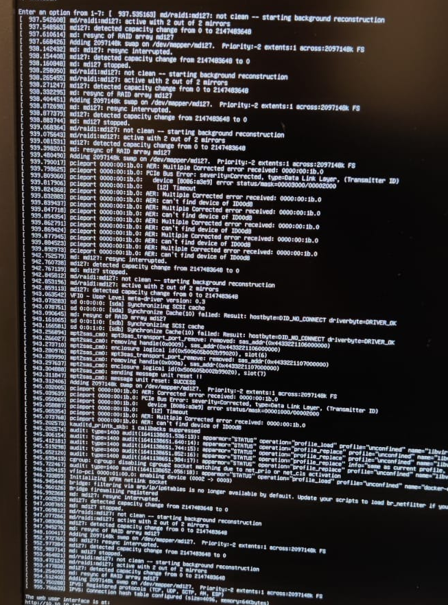

I'm doing some more investigation on the issue.
The system crashed today, so I tried to shutdown/restart the server multiple times.
It always hangs for 15 minutes at the stage:
"A start job is running for import ZFS pools (XXs / 15 min 11s)"
After the wait is over, the system booted:
- first time with 2 volumes offline
- second time with 1 volume offline. After a while, the offline disk came back online
- third time all disks online (but the boot process still got stuck for the full 15 minutes)
- fourth time - same as second time
"zpool status" now shows everything is ok after all disks come online
The console it shows a bunch of errors on the volume that's coming online only after boot.
When I shut down the system also showed error on the same volume that had more difficulty coming online: "failed unmounting /mnt/DISKNAME"

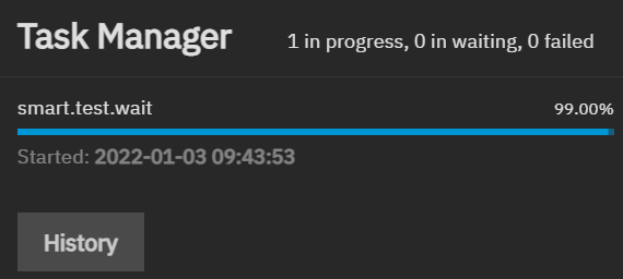

I reconnected the disk and did a quick test. The test hangs at 99% forever.

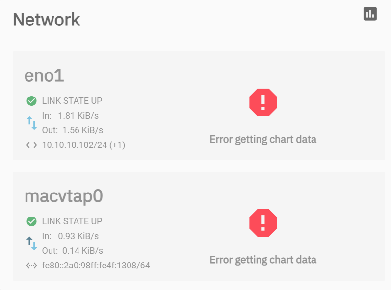

Also see the network error getting chart data error:
