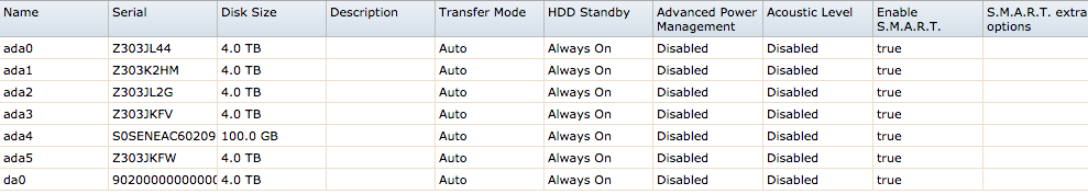

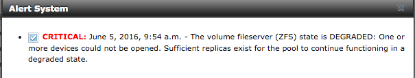

I got surprised about a degraded volume.
This is the output of zpool status:
http://paste.debian.net/714559/
Those are my devices:
http://paste.debian.net/714560/
I can see all 5 disks there were initially.
Please also see attached screenshots.
I'm running FreeNAS-9.10-STABLE-201605240427 (64fcd8e).
To me it seems like that my disk received some kind of new ID.
I'm unsure about what to do next. Please help!

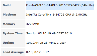

Can you post the list of your hardware please?

Yes and they don't list the MB model, if you use an HBA and what its model is, the PSU model, ...
Junicast
Mar 6, 2015
206
Here's my dmidecode output:
http://paste.debian.net/714600/
It's a Gigabyte P67-ud3-b3 Mainboard, no HW Raid controller, all drives onboard connected.
PSU is Pure Power CM L8 530W bequiet.

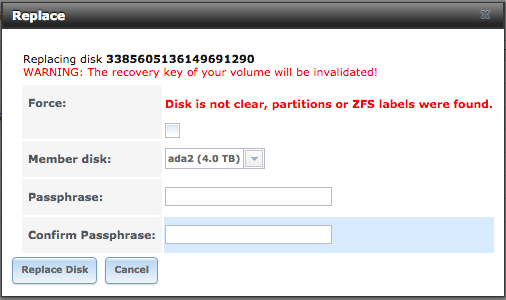

Well that's confusing. In Volume status I am able to replace the missing drive with the one that's been used for that Raid-Z before.
But when I try to replace it gives me a warning about a found ZFS partition. This is of course true, because it's the actual drive :smile:
Is my assumption right that my best shot would be to rebuild / resilver with that very drive and just hit the force radio button (see screenshot).

Looks like your pool is encrypted. Make sure you follow the documented drive replacement procedure very carefully.

In the end I actually did the replace procedure given in the GUI. All went fine. RAID Volume is ok again now and I also did the re keying and also backed up the keys.
