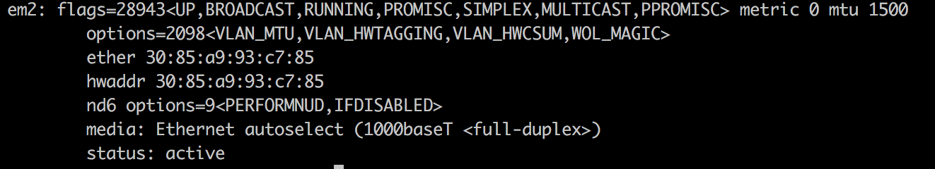

em2 is my FreeNAS interface that is working as it should:

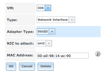

Here it is attached to the VM:

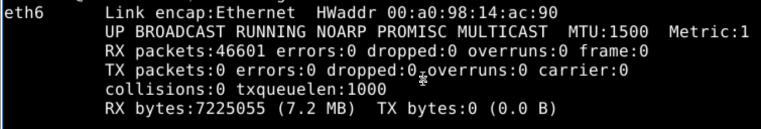

And here it is in the VM:

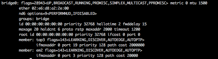

Ok, so I've narrowed this down the the bridge interface as the issue, but I'm still not sure why it's not passing all the traffic.
I've set the bridge itself to promisc, but running tcpdump on em2 vs bridge0 shows everything vs only broadcast traffic. I was looking at the bridge configurations and SPAN would be ideal, but it doesn't work in this configuration. Ideas on what I need to do to fix this?

Just so it's here, in case someone comes across this. You need to set maxaddr to 0 for the bridge interface, this is what tells the bridge how many MAC addresses the bridge will keep in its forwarding table. By setting it to 0, it just forwards everything, thus just repeating my SPAN traffic.
I set a tunable in the FreeNAS GUI, of 'ifconfig_bridge0' to 'maxaddr 0 promisc' in rc.conf and now it should be good to go.
