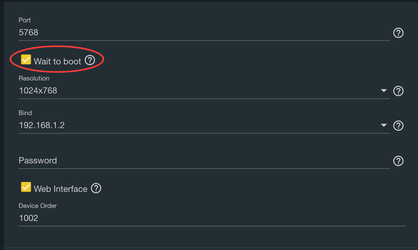

adam_0
Feb 17, 2019
This checkbox seems to have disappeared in FreeNAS-11.2-RELEASE-U1. Is the workaround to simply delete the VNC device ?
In FreeNAS-11.2-RELEASE-U1, I didn't set up the VNC device at all, but I was able to edit it. Virtual Machines -> Select "Edit" from the dropdown -> Edit the VNC device -> select "Wait to boot".

KevDog
Nov 26, 2016
462
The layout and how to change this is definitely NOT USER INTUITIVE. I'm currently on 11.2-U6. Here is how to get to the menu that adam_posted (#12). Using the New FreeNAS GUI (Not Legacy) -- Select Virtual Machines in the Left Hand drop down column. In the right hand column you'll be presented with a list of your VMs (assuming you have some). On the line listing your virtual machine -> Go to the far right and select the 3 dots and select Devices. You'll be presented with items such as NIC, DISK, CDROM, and VNC. Click on the 3 dots on the VNC interface and you'll be presented with the menu such as on post #12. Deselect Wait to boot.
