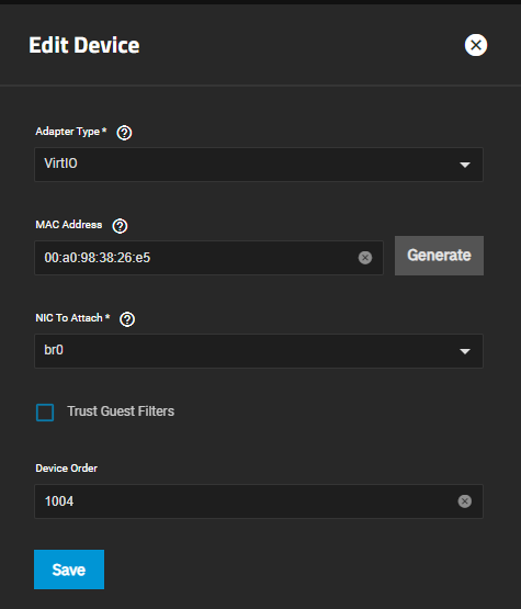

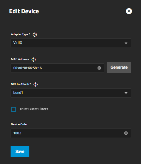

The VM has 2 NICs, one for bond1 (to access the internet and LAN), and another for br0, to access the host:

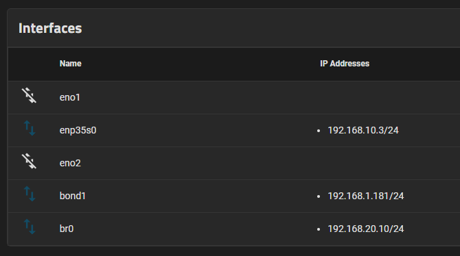

This are my interfaces:
![raw](https://cdn.karbust.com/BedO8/bafuNutI47.png/raw)
- br0 doesn't have any members.
- bond1 is from eno1 and eno2.
![raw](https://cdn.karbust.com/BedO8/NAdebUJi16.png/raw)
![raw](https://cdn.karbust.com/BedO8/vACuJIfU18.png/raw)
