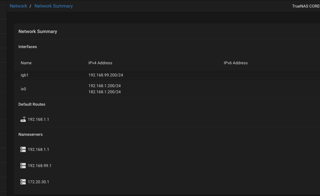

I have a brand new installed (bare metal) TrueNAS Core running version 13.0-US.3.
The system has a 1Gb network and a 10Gb network interface.
I have setup the management on the 1Gb network (.99.200 address)
The primary 10Gb interface is at 192.168.1.100.
This NAS is going to be used by multiple VM's each in different subnets 172.20.20.1/24 .30.1/24 etc with each in their own VLAN (20, 30, etc).

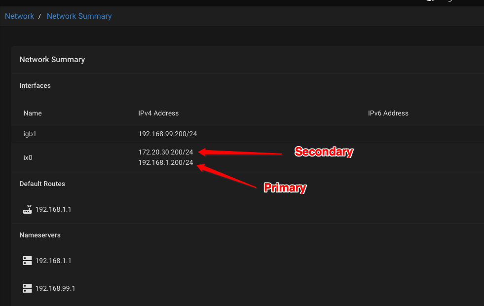

I am attempting to assign an additional IP 172.20.30.200 to the NAS. When I add the additional IP, it doesn't remain and eventually resets.
Problem is, it remains attached to the interface BUT is not reachable via ping from one fo the VM's on VLAN30.

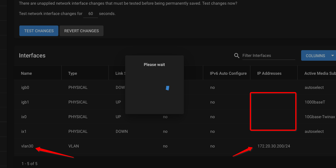

So, I went the alternate route and attempted to add a VLAN. In the setting I am required to add an IP so I add the 172.20.30.200/32 and hit the "Test".
Things spin and eventually I end up back at the Network -> Interfaces.

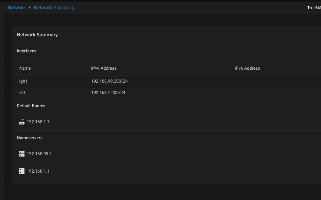

Here is where the issue is. The VM Now is able to ping and run iperf3 to the new 172.20.30.200 IP. BUT, the VLAN is NOT listed within the Interfaces list. Additionally, the added IP is no longer shown attached to the interface.
Everything is actually working. Problem is, if I Reboot the NAS, then since none of the network changes "saved" all connectivity from the VM to the NAS is now broke again.
I'm not sure if this is a Bug or something else.
Any help or insight to this problem would be appreciated.
