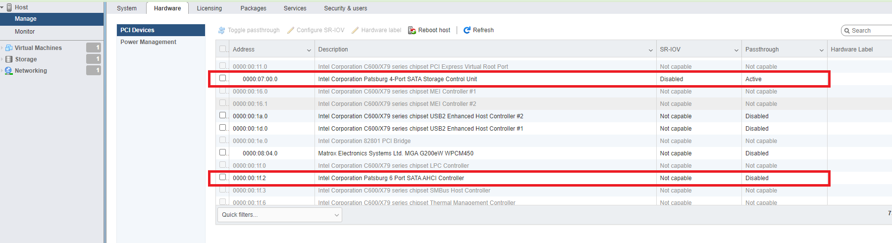

My lab server is running ESXi 7.0. The motherboard is a SuperMicro X9SRI-3F. It also contains a SCU (with four ports populated for SATA). Both the SATA AHCI controller and the SCU can be toggled for passthrough. See picture below of my ESXi hardware overview.
Now I don't know if the SCU behaves like a HBA or if you are able to boot from it (never used it) , but you have a choise what device you give to the TrueNAS VM. As you can see, on the picture both devices are black and thus not grayed out. In fact I have toggled the SCU for passthrough.
