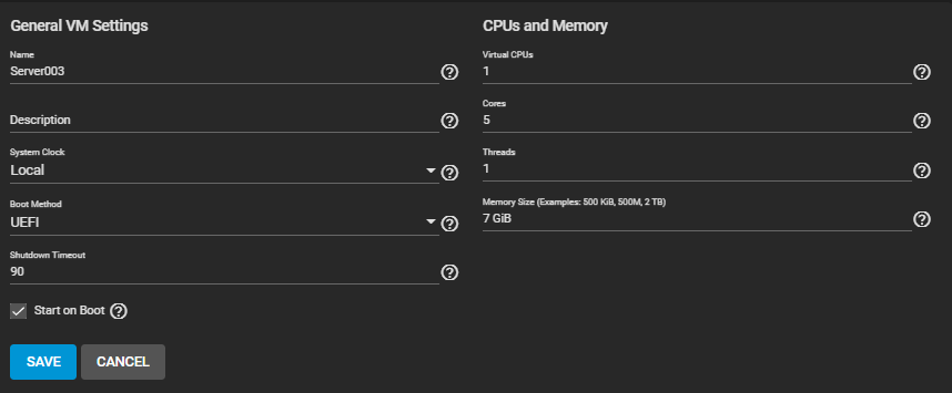

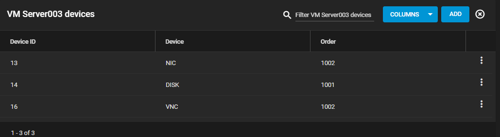

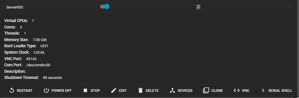

I don't know what are you talking about so I take a few screen shot. I hope at least one of them is right

Your VNC device and NIC share the same order. bhyve, the TrueNAS hypervisor is picky about such things. Try renumbering your VNC device to order 1003. Also make sure your NIC is set to VirtIO and not E1000 mode, by click on the 3 dots on the right next to the device order.

Once you asked me if I was using VirtIO I thought that this was the problem so I tryed to use AHCI and it worked fine. Thank you so much
