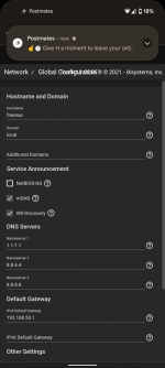

Please post a screenshot of Network>Global Configuration

Okay, new development. I can access the webgui via my phone, but not via my desktop. The only oddity in my network setup is a pair of Moca2.5 adapters between my router and desktop.

I guess you are running Scale (based on the fact that I've never seen that layout before...), but it looks good anyway.
Moca adaptors I know nothing about, but I'll bet you've identified your culprit. Can you find a way to use Ethernet cable directly to check it out?

It's running truenas core, maybe the mobile layout is unfamiliar. I'll try connecting a laptop via ethernet and seeing if that works.
Must be - live and learn... Thx for the education.
EDIT. That was it - I just tried it on my phone.
