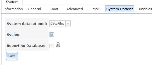

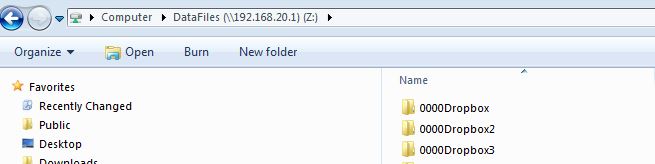

gearhead
Mar 6, 2013
137
Thanks for being so patient. I still don't see .system directory. I have attached to screen shots for your review. It should have appeared before the first directory.

You can't share out the .system dataset with CIFS, NFS, etc. The .system dataset is mounted in /var/db/system, which is not a valid location to share from the WebGUI. :D
gpsguy
Active Member
Jan 22, 2012
4,472
Obviously the OP didn't do it, then. To the OP - learn about the CLI. Most of us would SSH into ours servers and look at the data that way.
