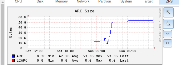

Asday
Jan 6, 2015
17
Good afternoon, future intrepid Googlers.
I needed to adjust the tunable `vm.kmem_size` as well. I set that to 59GiB in bytes as well, rebooted, and now it works fine. Well, I assume so. The commands output numbers I'd expect now.
The ARC hasn't had enough time to grow, yet.
pro lamer
Feb 16, 2018
626
Really cool how this forum has the same password hiding feature as IRC.
I guess the OP has already changed the password ;) since the password is still visible here.
Sent from my phone
Asday
Jan 6, 2015
17
It worked.
@pro lamer :^) :^) :^) :^) :^) :^) :^) :^) :^) :^) :^)
