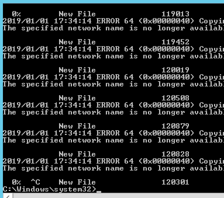

However, when running Robocopy from the "older" server, to the new one, it works perfectly for 8, 12 hours,
then suddenly I get the Error 64, "the specified network name is no longer available" as shown in the image bellow.
robocopy "Source" "\\10.0.0.1\**" /copyall /mir /fft /r:1 /w:1 /mt:16 /zb /np /ndl /xjd
robocopy "Source" "\\DNS.Domain**" /copyall /mir /fft /r:1 /w:1 /mt:16 /zb /np /ndl /xjd
Wont use Copy:DT, as I want to get the correct permissions.
And as stated, it does work, but after a while, on larger files, then it creates the error.
When the error starts, then I can't "browse" the FreeNAS, I can Ping it, but I cant access by //servername/
in file explorer, or in powershell. They will get a time out, as if SMB is crashing, and not responding.

Image of Robocopy error
27451

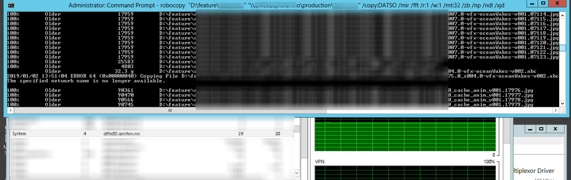

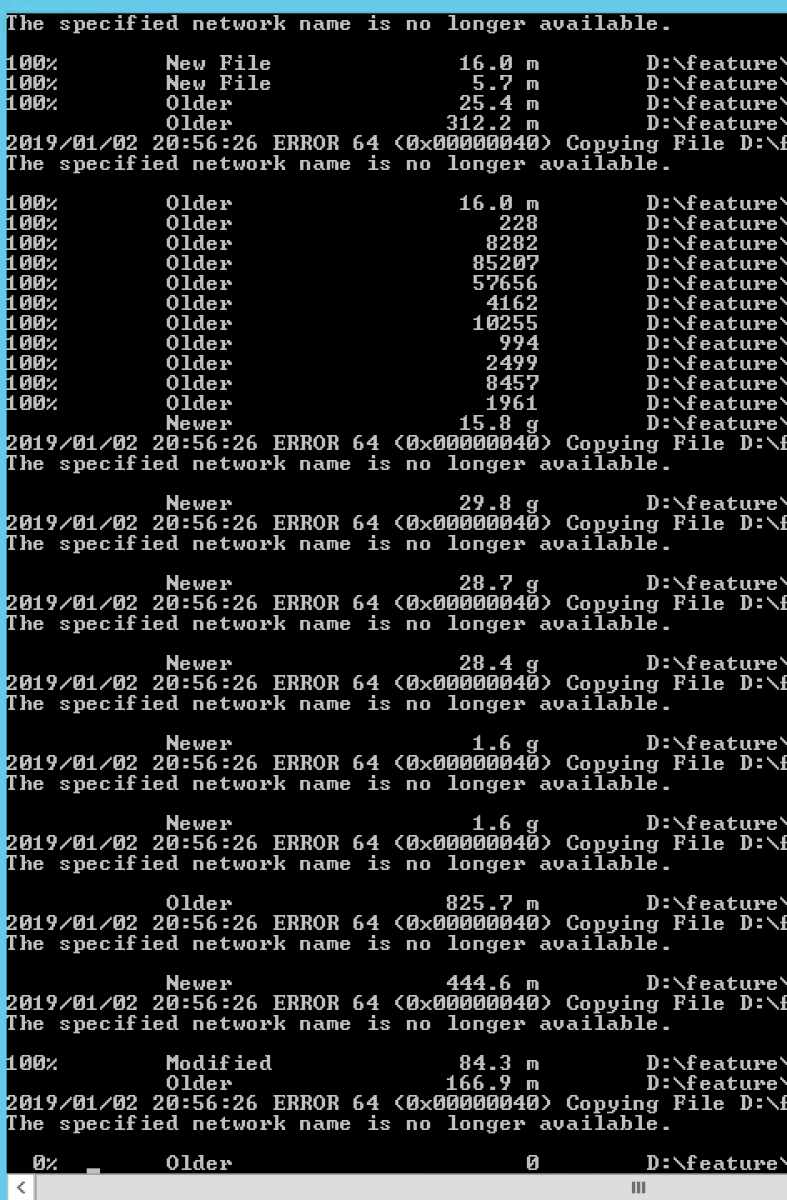

So I got the same error again, on a 32.3 GB file,
What happens, is that SMB Drops the connections slowly, so we see a decrease in speed,
then suddenly we are at 29 Bytes or similar.
and then the file times out.
Strait after the time out, then it continues with smaller files, and continues working, as if nothing where wrong.

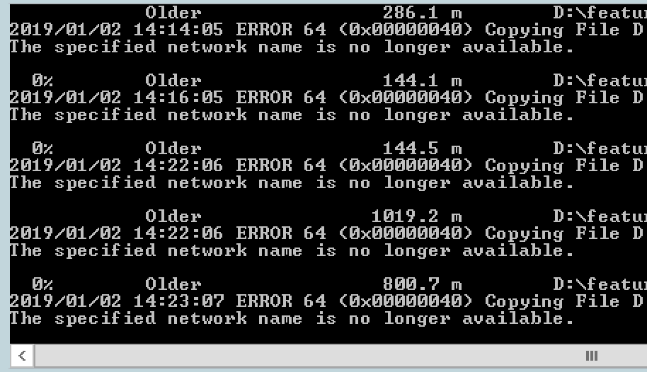

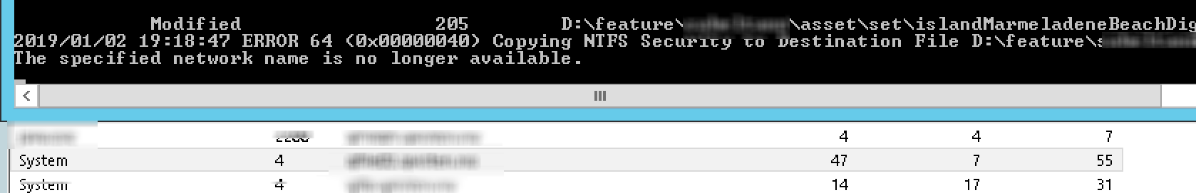

FYI, before I added that, i got more errors on smaller files.
Adding Tunable
Variable : net.inet.tcp.reass.maxqueuelen
Value : 1448
To sysctl

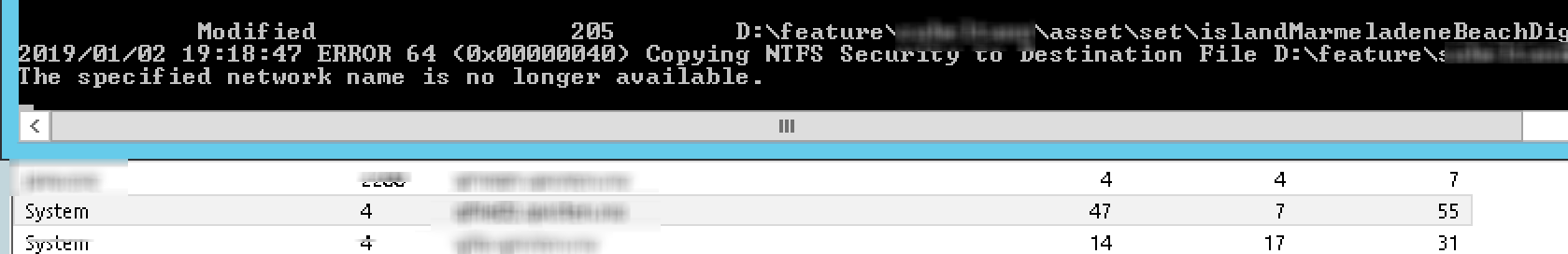

ok, i did test until 19 ich, and I do get the same errors.
Same as before...
Builds up, all files, then somehow it suddenly hangs, all connection Bytes drops, and its off.
and, while it runs, its also dropping browsing of files, so it hangs if trying to accsess the Network Drive
Same as before...
So just in an kinda desperate move, I tried :
following in Auxiliary parameters:
force unknown acl user = yes
case sensitive = yes
socket options = TCP_NODELAY
ea support = no
map archive = no
map hidden = no
map readonly = no
map system = no
Still the same kind of error, one file bounces, and kinda "kick starts" something, and the rest follows.
all the files are of some size, while the others are smaller size.
Weird !

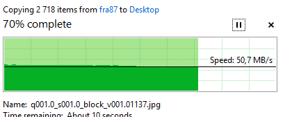

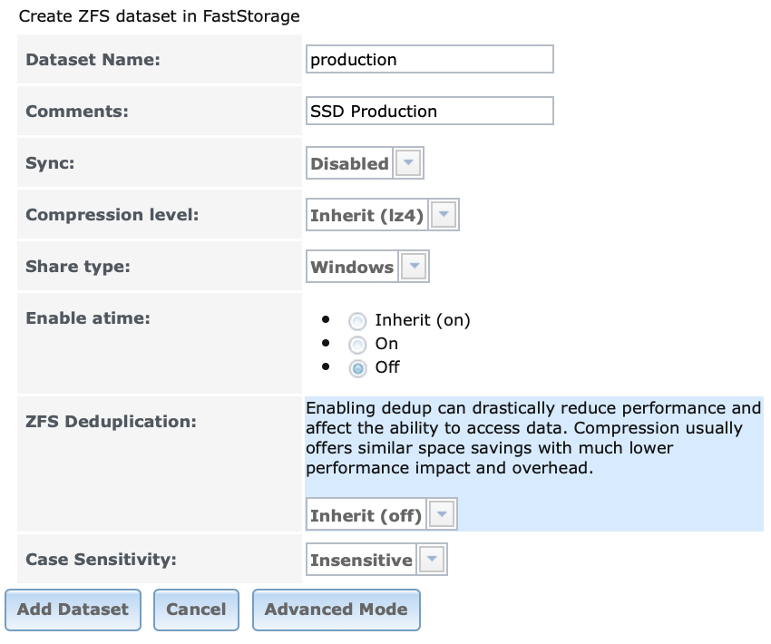

Thanks for the replies.
I think I have stabilised it...
So, this is the Dataset created.
I know that its bad to turn of Sync, but I where desperate to test everything,
get it stable, and then turn on a feature pr time.
The Auxiliary parameters of SMB are :
socket options = TCP_NODELAY IPTOS_LOWDELAY
hide files = yes
store dos attributes = no
ea support = no
map archive = no
map hidden = no
map system = no
map readonly = no
strict sync = no
sync always = no
I will turn on one feature at a time, and then report back the findings.
at the moment, Directory listings are amazing fast.
Transfer rates are around 50/60 MB/s on Single thread, Small JPG Files. ( 200k )
on bigger files, its constant 108MB with a single thread.
If multithread Robocopy, then its slower actually... so there is still some research to do.
First priority is to turn on Sync, on both SMB.conf and ZFS Dataset.
then ill test more.

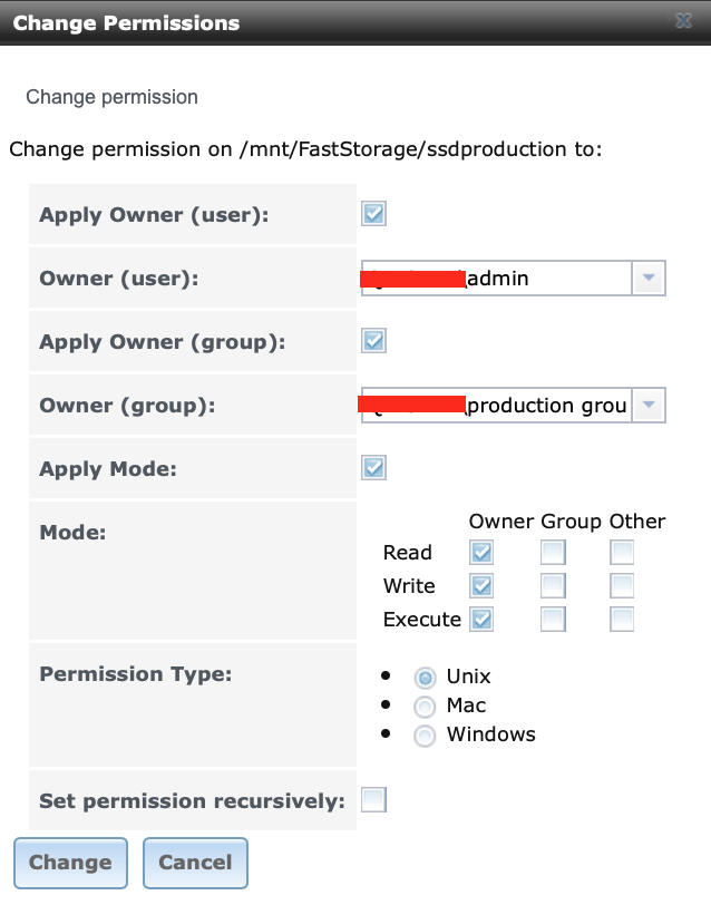

Hey!

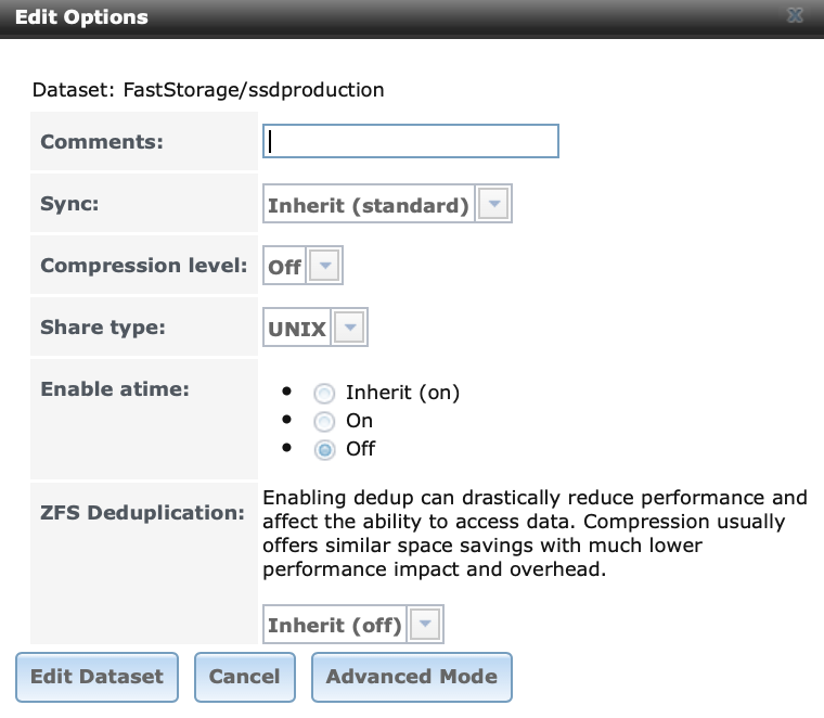

So, i have fixed some solutions, and unfortunately,
the workaround required some changes that i dont like.
First off, the dataset had to be a UNIX share type, not windows.
The permissions, were still set with Active Directory Users and Groups
and the SMB Axulery parameters where
case sensitive = false
This solved the Robocopy error from an "harsh" windows environment,
that where based on recursive ACL strategy, ( all ACLs where parented )
- So two lessions.
one , ACL sucks... dont do recursive , and forget to copy the main folder.
two , FreeNAS is mostly tuned for good samba speed ( thanks iXsystems! )
