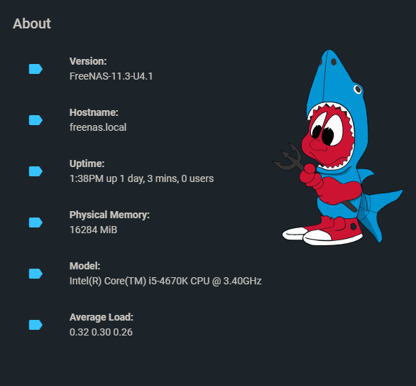

What freenas/truenas are you running. ?
There was an issue with this some little time ago.

Seems like they are using 11.2 and they are talking about a fix with 11.3 which is what I'm on. So am I missing something? Should this have been solved already?
